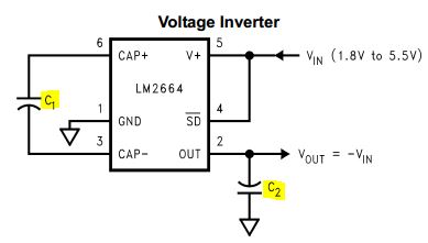

Hi Team,
I'd like to ask about LM2664.
Our customer wants to use ceramic capacitor to CAP + and Cout.
Although recommended Cap is OS cap.
However, Can I use a ceramic cap?
Yusuke / Japan Disty
The datasheet suggest that low ESR capacitors are preferred. Table 1 on page 6 of the datasheet includes ceramic types. So yes, ceramic capacitors are also recommended for LM2664.
