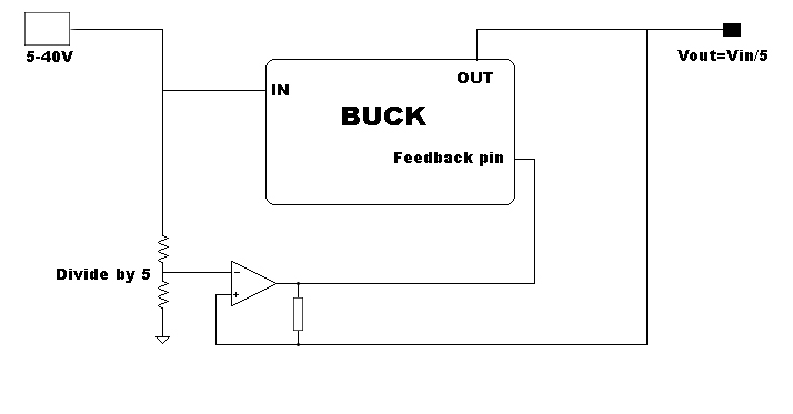

Hello. Is it possible that this buck arrangement will work? In theory it works but I'm not sure do I miss something. Also, how critical is comparator speed? Should it be with hysteresis?

Hi Frano,
No this is not possible on account of too much gain .
Anston
Hi Frano,
You are running the op-amp in an open loop configuration. The comparator internally has a large gain as well. Compensating the feedback will be very difficult. You can experimentally try this and independently evaluate the design.
