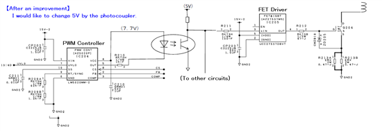

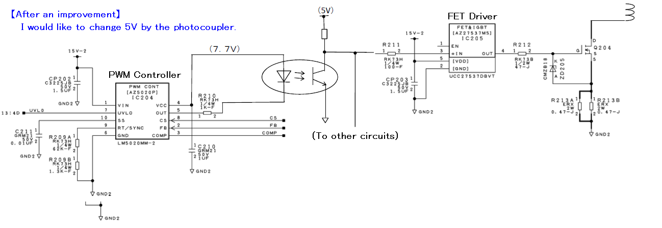

Please let me know 3-point below of LM5020.
・OUT pin voltage are 7.7V, customer want to change 5V.
The old method is dropped for the diode. (Please see below)
Customer is inquiring to change into a photocoupler these days. (Please see below)
Is it no plobrem?
・Please let me know about OUT pin Max_current.
(I think that Max_current is 0.5A, is it right?)
・If there are other good ideas of 7.7V→5V, please let me know.
