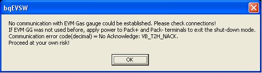

  • No, I have not started usign the BQeasy software. I just tried using the software by plugging the eval module to a 3.6V supply and it said
    What would have caused this error. Iam unable to do anythign with eval kit at all..
  • Did your eval kit include an EV2300 (USB-I2C box)?
    First you must plug it in to your PC and allow the drivers to be installed.  It will install TWO drivers and you might have to interact with the dialogues to get them installed.  If you plug the EV2300 into another USB port, it will need to install the drivers again for that port.  Anytime you plug it into a new USB port, it will need to install the drivers, FYI.
    However, once you have the drivers installed, you can start the bq Evaluation Software.  If it finds an EV2300 plugged in, it will hook into it.  If there is a powered EVM plugged into the EV2300, it will query it for the device and firmware version.  If you have installed that version of EVSW, it will automatically launch.  If you don't have that version or there is no EVM or EV2300 plugged in, it will pop up the dialogue box where you can select your device and version.  If you pick one and continue, but it can't find a gauge to talk to, it will give you the message you just saw.
    So...
    First plug in the EV2300 to your PC by USB and make sure the drivers are installed.
    Second, connect the I2C port of the EV2300 to the I2C connector on your bq27510EVM.
    Third, apply 3-4.2V across the Pack+ and Pack- connectors on the bq27510EVM.
    Fourth, start your bq Evaluation Software (EVSW).
    If this is what you did and you still got the error, let me know.

  • It sounds like your communication is fine but you have a different version of firmware in your IC than the version of EVSW that you are running.
    Despite the warning message, go ahead and click "Refresh" on the DataRAM screen.  It should read a bunch of registers and they should turn color on your screen instead of gray if the reading is successful.  Give me a screenshot of this.  The top bar of the window will show the firmware version that EVSW is expecting.  The bottom bar of the window will show the version actually read from the IC.  Did you upgrade to bq27510-G1 (v1.12) yet?

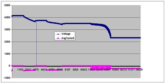

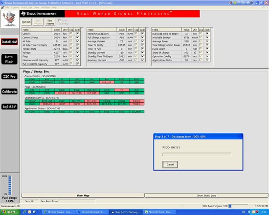

    Liek, How I discussed earlier, Im tryin to do the  chemistry cycling again.However, this time when I reach step 2, I get the BQEASY to say "disharge from 100-60%", and RSOC =100.15, 100.20, 100.74 and so on..somethihg wrong..it seems to be counting up..rather than down..> or is it jus a software bug?
  • Can you post a screenshot of the error you are seeing?  I'm not familiar with your description.
    I just plotted the Voltage and AverageCurrent from your log file and it looks very strange.  I inserted the plot below.
    What we need is a continuous discharge from 4.2V to about 2.8V to identify the proper chemistry ID for your cell.  Unfortunately this log shows a discharge to 3.7V, then relaxation, then discharge to 3.4V, then relaxation, then an intermittent discharge until it reaches about 2.3V.  This cell is probably damaged now.
    I'm not sure what is going on with your FET/relay circuit, but maybe you should just remove it, begin the logging, and start a discharge from full to around 2.8V that you stop manually.  If you get a smooth discharge curve then send me that log and I will identify the chemistry for you.
    I'm sorry this is turning out to be such trouble for you, but let's keep trying and we'll get it figured out!
  • Hi David,

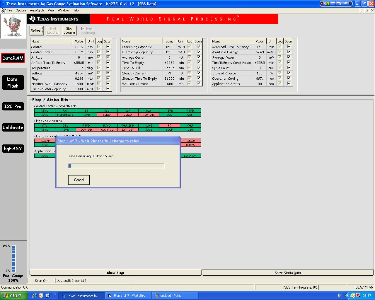

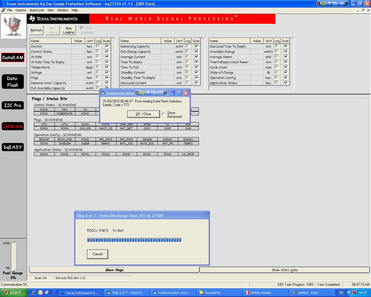

    After reading your post, I have a feelein if I am doing something wrong. But, I have definitely followed exxactly the way BQEASY takes me through. The way, I do is: connect the discharge circuitry to load, and battery to battery terminals. I then do step 1 to step3 of BQEASY, and for step4:I do the following: enable chemistry selection---> Cant identify chemistry --->Test it ON ---> Charge done ---> start test.
    Once I start the test, it goes through 7 phases or 7 steps. If  I remember it right, it is:
    Step Charge/discharge Remaining Voltage displayed on  BQEASY
    1 Relax charge for 2 hours 4.15V
    2 Discharge from 100% to 60% at  C/10 3.7V
    3 Wiat 2 hours for discharge from 100% to 60% to relax 3.6V
    4 Discharge  60% to 10% Not noticed
    6 Pulse Discharge from 10 % to 2150 V
    Battery drained
     Note:
    1) I dont know what step 5 was...
    2) Step 7 could not be reached since my battery had already  been drained .

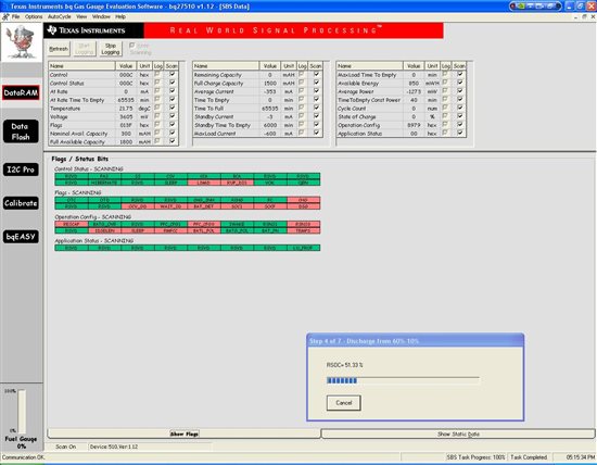

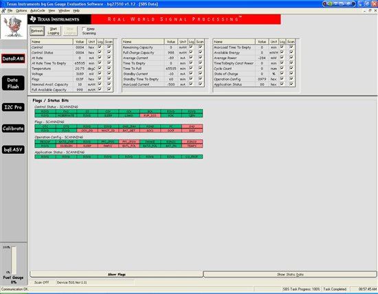

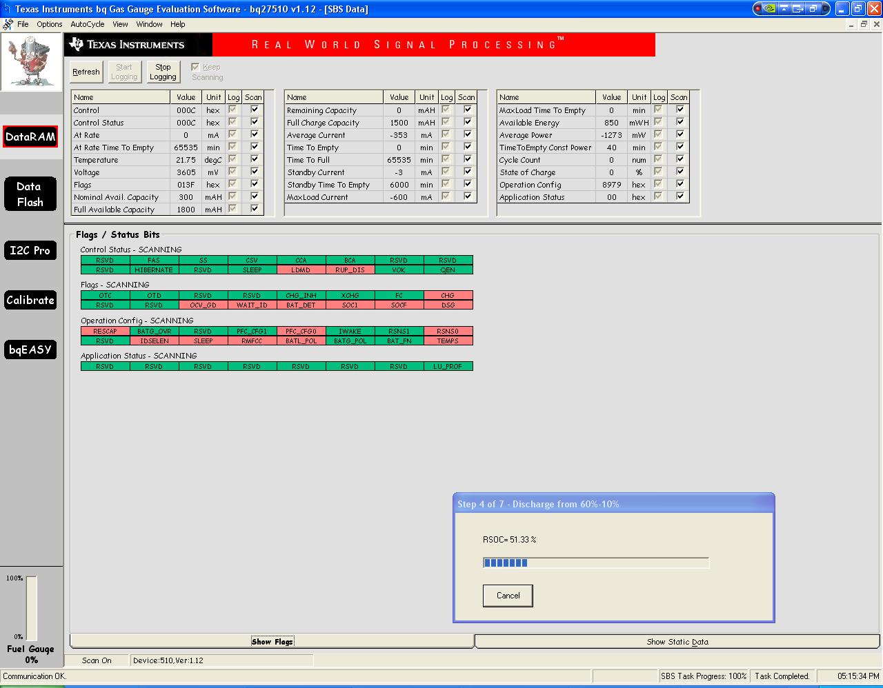

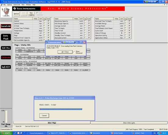

    3) I have attached images for the Step1, Step4 and Step6 with their respective steps as file names.
    That was how my first Chemistry cycling test looked like, and the log file of which I have sent to you. So, I presume, what you see in the log cycle as intermittent charge ,relaxation and discharge cycles are as controlled by the BQEASY software itself which is how I have done.
    However, after having sent you the log file, I decided to use a relay instead of a FET, and thats when I got that error stated in the previous mail. I dont know if I should call it a a error. The problem was in STEP2---- Instead of discharge from 100% to 60% it used to go Discharge from 100% to 100.1%, 100.2% and so on... and RSOC was rising from 4.2V to 4.21 , 4.22..and so on...  I assume, this could be  a problem of my circuit. I shall attach the  image under the name "error_chem cycle2".
    I thank for your pateince as well, in helping me sort my problem even if I havent got anywhere with it. Because, I tried contacting the support team at epic@ti.com and response seems to be very upsetting. The team/person used to respond immediately until I purchased the kit and there has been little or no repsonse ever since. I have not beeen able to demonstrate any postive results with this kit in the last 1.5 months which pulls down me a lot. However,like how you say,  I hope to get it sorted soon and get it up and running with the rest of my project.
    Thanks and Regards,
    SA.
    The pics for step1, step4, step6 and error-chem_cycle 2 are attached as below.

    It looks like chemID 227 is the closest for you to use.  Please choose 227 in bqEASY to program into your dataflash, then perform the learning cycle to create a golden image.
    I also calculated the optimized Ra table from your data.  After your learning cycle your Ra table should be similar to the one in the attached partial GG file.  You can take the Ra table, use the decompression formula on page 5 of SLUA450 and plot it in Excel.  Plot the one from your learned data and the one from my file.  They should be similar.
    I hope your learning cycle goes smoothly.  Please let us know if you have any problems creating your golden image.
