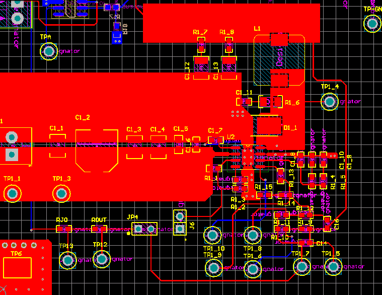

    Also here is my layout, because i want to adjust the output voltage, so add several zero resistor in the resistor devider, i am not sure the layout would cause this behavior.

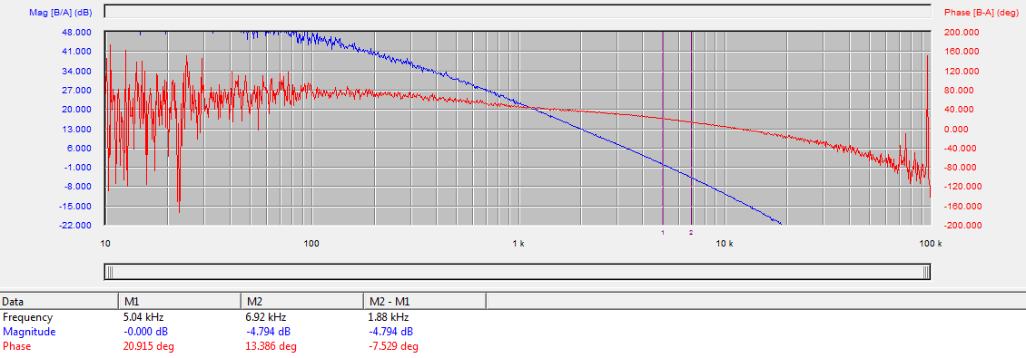

  • Today i test the loop gain: fco=5kHz, phase margin=21degree, but i am not sure why the same compensation, but has different loop gain?
    Additioanlly, use AP Model 300, set AC source is 50mV, AC BW=1kHZ, sweep points=1000,  why so large noise under low frequency?
  • It is not unusual to get noise at one or both ends of the frequency sweep.  You may have to adjust your amplitude, or possibly check your termination.  I can't tell you specifics as I am not familiar with that particular analyzer.
    At any rate you need to adjust the compensation.  You should try for Fco about 50 kHz with 50-60 degrees of PM.
  • Hi Milo,
    How is this going? I worked on the TPS54340-Q1EVM and can help with any remaining questions you have on it. I was out of office for the holidays.
    One thing I noticed reviewing the layout is the output capacitors do not have a very solid connection to the VOUT plane due to the added series resistor. This would add inductance and I wonder if it is enough to affect the loop. Could you try soldering some thick wires from the output capacitors to the VOUT copper plane to try to have a lower inductance connection?
    Also how is this board connected to the transient load? This should also have a low inductance connection through a copper plane.
