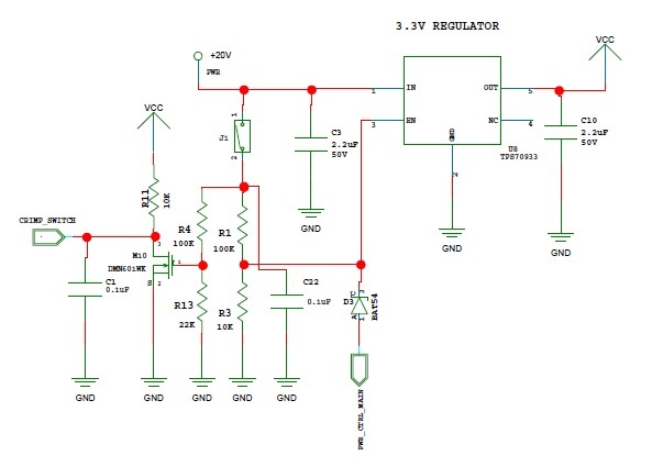

Reg output current issue in TPS70933
Other Parts Discussed in Thread: LM317, TPS62177
Hi All,
I have suggested TPS7A4533 to one of the customer in the datasheet it is mentioned quiescent current is 1microamps but it is taking 100microamps so i suggested TPS70933 . In TPS70933 the leakage current is matching as per the datasheet but although it is rated as 150mA o/p current not able to pull more than 50mA. Beyound 50mA ouput is toggling and chip is getting heated up. Attached is the output waveform at 80mA for your reference. Kindly help to resolve or help to suggest a right part matching the  specs equivalent to TPS70933. kindly need help.
 Aravind
