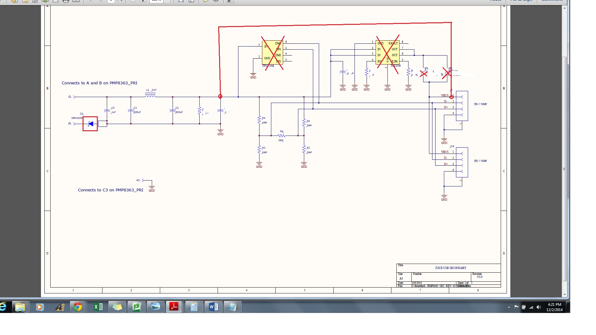

    I have a 'Q" about the below sec side of the flyback  topology using UCC28710. We've used the below sch for the sec side in the past. Now I'd like to remove the 2 ICs  TPS2514 & TPS2556 as crossed below to save cost. Sd the circuit not work if I directly connect the + of C2 to the V+ terminal of the USB port as I have shown below? Unfortunately I dont see the open circuit 5V at the V+ & Gnd of the USB channel after removing those 2 ICs. But in your ref design 5V/2A you have not used any of those ICs but the circuit still works.
    In my case I found the diode D1 getting damaged each time I remove those ICs & hook the output direct.
    Can you please suggest what am I doing wrong here?
    Really appreciate your feedback. Thanks in advance, Ari

    There is a PMP8477 (120Vac 5V 2A) reference design that uses transformer RLTI-1072 and a PMP8363 (120Vac/230Vac 5V 2A) reference design. I cannot find a RTLI-1061 or RTLI-1067 part.
    The schematic you attach looks like the secondary of the PMP8363 which uses the RLTI-1067 transformer. This reference design uses flying leads on the secondary leadouts. Are you sure that the leads are connected properly and that the schematic matches what you have actually built? Or are you using the RLTI-1072 transformer on the PMP8363 design ?
    There is a note on the PMP8477 schematic that the polarity is wrong on the pcb board. This means that if you are using the PMP8477 circuit board then you will need to reverse the secondary connections. The schematic is correct so you should wire up the pcb as in the PMP8477 schematic.

  • Thanks John for your reply. Pls note that the design I inherited is the ref design PMP8363 which uses RTLI_1067. Leads in my circuit seem to be correct as the circuit (with U1 & U2 in the secondary) which I sent you previously works fine. I'm not using xfr 1072.
    The sec side of TI design looks like below which has no U1 or U2 as shown in the fig which I sent in the previous message. I am wondering if I remove those U1 & U2 which I have crossed in the earlier fig the circuit still does not work. I connected C2(+) directly to V+ of the USB port after removing U1 & U2 which is the same situation as in TI ref design PMP8363. Therefore, I expect to see +5V across C2 but it shows no voltage! Any suggestion is appreciated. Pls let me know if I was able to explain the prob I'm facing or will rephrase it.

  • Di you connect C2 (+) to pin 1 of the USB connector and connect C2 (-) to pin 4 of the USB connector?
    If you did then you should measure whatever voltage is across C2 also between pins 1 and 4.
