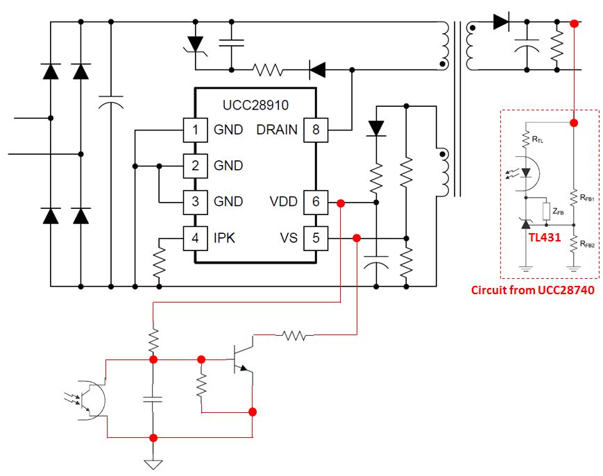

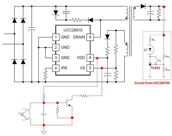

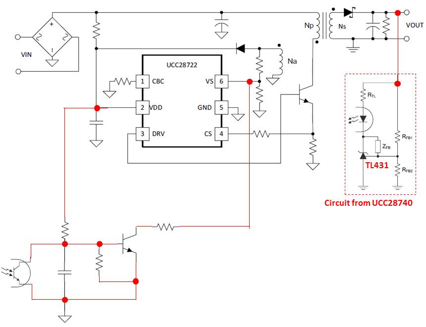

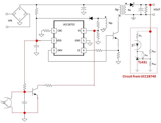

Our customer hope to use dynamic BJT drive type controller to reduce total BOM cost, so UCC28722 can be candidate. But also they hope to use opto-coupler feedback to achieve tighter accuracy and transient response. Then do you have any reference circuit for UCC28722 with opto-coupler feedback? Or do you have other solution except UCC28722?
