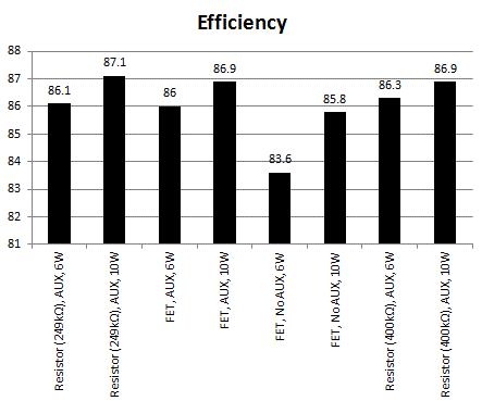

    ii) There are two ways to configure for use with an AUX winding: (a) a linear regulator for start up (as in the normal EVM design: resistor/zener/N-FET) and set at 'X' volts for example, and then you configure an AUX winding to diode connect to the linear output at 'X'+2 to 3 volts, for example, to effectively turn the linear supply off when the AUX voltage is present.     (b) you do not have a linear but use a resistor only. At turn on, VCC charges through the resistor until VCC is above VCC UVLO. When the part turns on VCC UVLO must have a large enough hysteresis that the converter can run long enough to bring up the AUX winding and supply the VCC voltage.(in our case this would require a VCC cap of ~22uF)  This method eliminates the linear.  In each case as the output is dimmed, the LED voltage drops and then the AUX voltage drops.
    Using method (a) is the most compatible with TRIAC dimming because as the output voltage drops the linear will again begin to supply the controller current and the part can continue to run.   in (b) there are two issues, becuase the AUX voltage will drop you must either live with a smaller dimming range (the output will shut off earlier) and because at turn on, if you are dimming, the input voltage is lower you may not turn on until the dimmer is moved higher in range to allow VCC to charge enough through the series resistance.
    So the best choice for dimming is to still rely on the linear or your range suffers and the dimmer range will have a lot of hysteresis. Meaning you will dim the light and then shut off, but then you will have to increase the dimmer a lot to start up again. For a dimming solution, operation with the supplemental linear is recommended. You increase the efficiency, but do not save the linear parts. In your case this may not be the best option if you're trying to save parts and space.  Some efficiency examples are shown below, for comparison. The 6W and 10W are the end solution output power. 'FET AUX' is the solution described above in (ii) (a)  and 'Resistor, AUX' is the solution described in (ii) (b).  'FET No AUX' is a solution similar to the EVM where to AUX winding is used.

  • Hi Luca,  The designs are very different if you need to make it dimmer compatible or not. Non-triac dimmable is much simpler.  For non-triac dimmable you could use the resistive start-up with reasonable (~200ms to 300ms)  turn on delays and use the coupled inductor bias.
    One way to increase efficiency and still use the linear is to power it from the bottom of the LED stack (LED -) Then you are not dropping the whole line voltage across the linear. With a high stack voltage like you have it will help. The trade off is that you need to increase the VCC cap from 0.1uF to 1uF up to 10uF to 22uF as the VCC cap will need to provide the controller current when the line is below the LED stack voltage.
