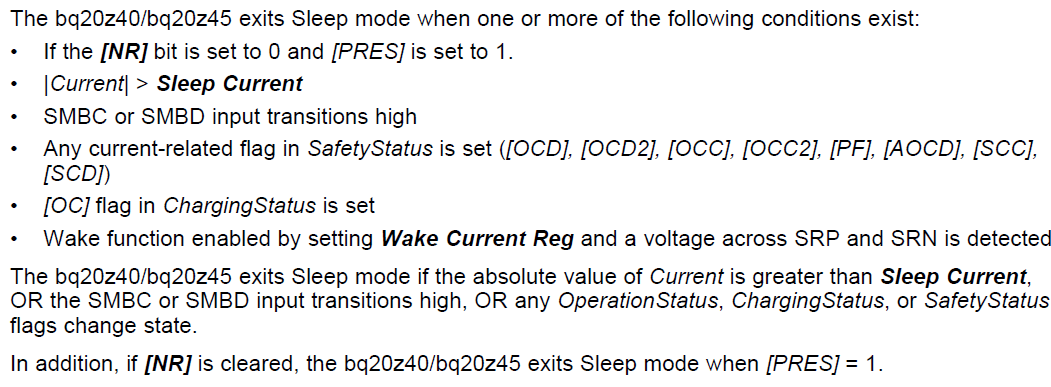

  • Well as you imply the TRM clearly says
    " In Sleep mode, the bq20z40/bq20z45 measures Voltage and Temperature at 5 s intervals and Current  at 20 s intervals."
    As far a I know those times are not programmable but even if they were the bigger concern is that your gauge seems to be ignoring them and waking at 1 second intervals and not 5 second which begs the question why? I am wondering whether something else is actually waking the gauge ?
    Per TRM
    So you should check that none of these conditions might exist.
    The sleep current is 10mA by default and I am wondering did you change that?  What is any load across the battery doing while it is asleep, could any activity on the load side be waking the gauge at 1 second intervals? Is the system host micro waking and causing the battery to wake ?  If sleep current is still 10mA then I would not expect a load side 500uA draw to wake it unless there is also some kind of initial large current spike as well waking it . Is this a removable or non removable gauge , are you trying to charge  while asleep ?  Lastly what are the SMBC and SMBD lines doing, could they be tranistioning high to wake it ?

    I had a chance to play a bit more with sleep mode on my EVM. I think the first important point to make is that you have NR set to 0 which means your pack will not sleep unless PRES is 0, which means the pack must be removed from the system and syspres line will be unconnected.
    From the scope shots I have taken it seems that TOUT and /PRES pin signal activity on EVM is different depending on the state of NR.
    With NR =0 ,  I observed there still seems to be a lot of activity at a 250ms period which I believe agrees with your observations in earlier post.
    If you set NR =1 then the 250ms activity disappears completely leaving just the 5 second expected pulses so I believe the extra activity is somehow connected to the part testing the /PRES pin to see if the removable pack (ie NR=0) got inserted into a system while asleep.
    Rereading the earlier posts it seems you may have connected /PRES differently to the EVM schematic so I am wondering if any additional components you have on /PRES,  or TOUT for that matter,  may be the source of your increased current during these extra sample times?
    Let me know what you think, I am wondering if you already reached that conclusion ahead of me and no longer need me to look at this?
     Let me know if you want me to measure the currents in sleep mode on my EVM.
    Mike

    When using the EVM, I have SYSPRES connected to +2.5V and on my PCB, I have /PRES pulled to +2.5V through a 275k Ohm resistor (there is no connection, 100k or otherwise, between TOUT and /PRES on my board). I have pulled those nets high with NR=0 to get the pack to go into sleep mode.
    To see if there would be a reduction in sleep mode current, I disconnected SYSPRES from +2.5V on the EVM. I did observe a slight decrease in sleep current but only enough to bring the EVM down to the level seen on my PCB. The decrease is due to the EVM thermistor circuit no longer being powered through SYSPRES.
    I then set NR=1 and commanded the EVM to go into sleep mode. As you observed, the pulses on TOUT only occur a 5 second intervals. This reduced the average sleep current from about 112uA to 87uA. It also makes sense that the 250msec activity is the BQ20Z45 powering TOUT to scan the /PRES pin.
    In my system it is relatively straightforward to pull /PRES low vs driving SMB or SMC high, making /PRES low the preferred choice for pack wake-up. I can pull /PRES to 2.5V to eliminate the dependence on TOUT being driven to pull /PRES high during pack insertion scanning. Pulling /PRES to the 2.5V net creates a small penalty in quiescent current when the BQ20Z45 is active but the penalty is three orders of magnitude less than the current my system draws from the active battery pack.
    Given that sleep current can be reduced if TOUT is only driven at 5 second intervals, is there a setting that can be used to disable the 250msec pulses on TOUT when NR=0?
    Doug

    there does not seem to be anyway to disable that or change the timing,
    Mike
  • Mike,
    Ok, thank you for looking into the timing parameters anyway.
    If I have properly understood our discussion, it appears that the BQ20Z45 sleep mode behavior that I have observed on my circuit and the EVM is normal and expected to happen when NR=0. Do you agree with this conclusion?
