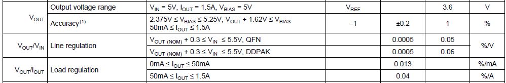

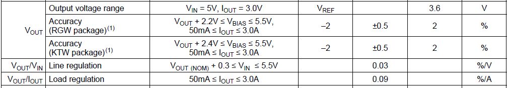

Now our customer has evaluated TPS74301 and TPS74901 and then they have question about Vout accuracy. Is the Vout accuracy listed in electrical characteristics is guaranteed over temperature, load and line? I believe it should be correct. Your comments will be appreciated.

  • Hi Sonoki,
    Accuracy is tested over the stated conditions in the third column.  The Min and Max columns are tested over the entire operating temperature range since the 3rd column does not state a different temperature range for accuracy.  These test conditions cover temperature, line and the stated load.
