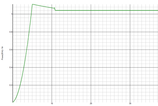

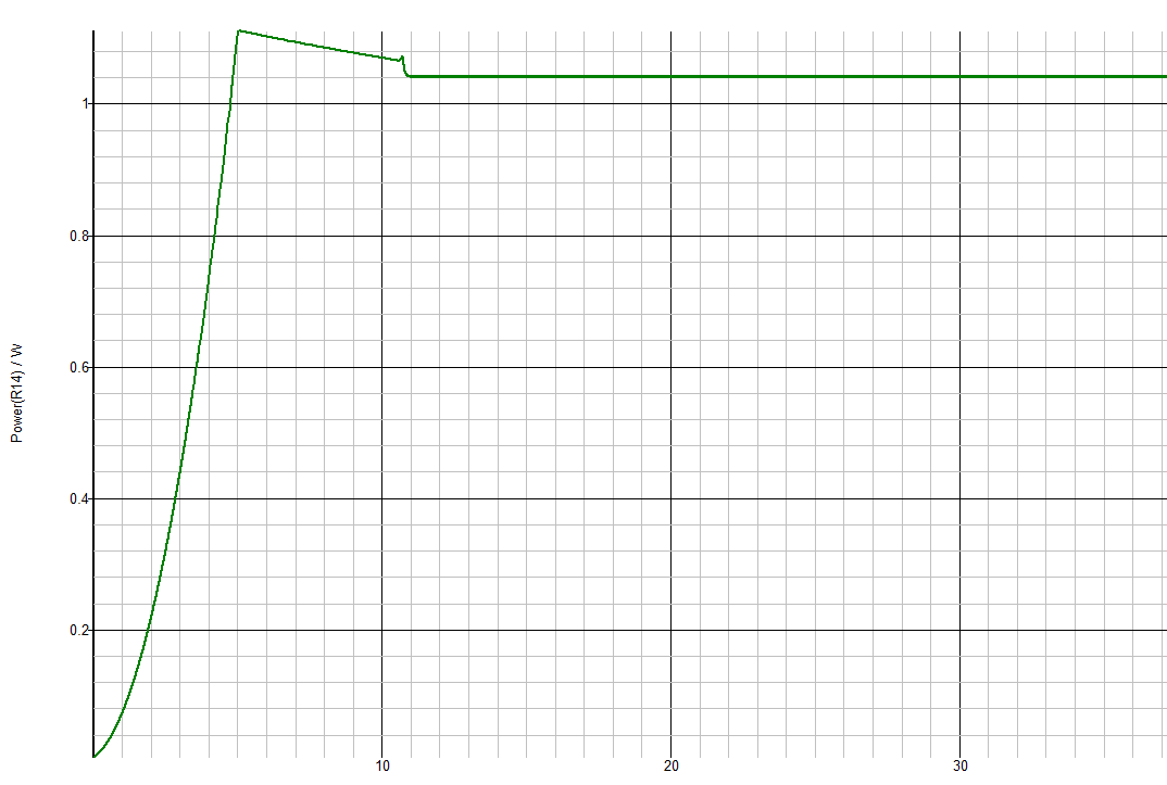

I am using UC3844 and I am getting pretty high Startup resistor dissipation in Steady state? I was thinking Startup resistor plays role only at startup and in steady state the power is drawn from Auxiliary. But looks for peak current required for Mosfet Turn on is supplied by this start up resistor and causing a power loess in steady state. I am having 200-500V input and 10W multiple output DCM and I am using 220K startup resistor. I am attaching the power dissipation. Any idea why we get continuous power dissipation across startup resistor.

    Your issues is that the 220k is always connected between the 500V  input and the VDD pin of the ic.
    Once the power supply is up and running, you can use a transistor arrangement to switch the 220k out of the circuit.

    Thanks for your quick reply. What I am observing is the Chip is taking mean current 23 mA, 20.7mA from Aux and 2.3 mA from startup resistor in steadys state.
    Is that normal? I having trouble to understand the datasheet parameters. It says normal operating current is 17 mA and startup current is 1mA. I observing startup current more than the datasheet.
    Another problem is if I have resistor more than 220K it is not starting for lower voltages such as 200V?
    What should be the range of start up resistor value?
