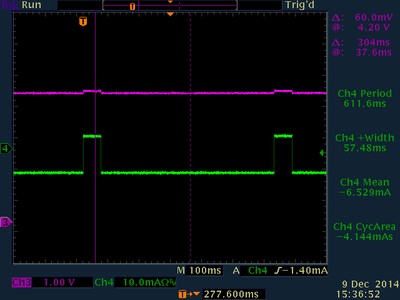

    The following is a  d-scope capture with the part showing charge complete (CHG goes high).
    The trace in green is from a Tek clamp-on low current probe, where a positive current value is current flowing into the battery..  The microcontroller on board is permanently held in reset during all of the the testing.  I load the output with power resistors to simulate loads ranging from 10mA to 350mA however the load current doesn't affect the o-scope plots.
    As you can see, from the plot the current is flowing from the battery even when power is connected to the circuit and the bq part is not loaded.  The average current is from pulse to pulse is (-4.144mAsec / 0.6116sec) = 6.7mA which will slowly discharge the battery unitl Voreg - 100mV.  This average current seems excessive.  Do you have any thoughts or is this how the part works ?

  • Wenjia,
    You are correct.  I tried two different configurations with same effect as show on the o-scope.
    In the first config we tested has EN1=0 and EN2=1 with a 3.32K resistor to ground on ILIM pin 12.
    The second config we had EN1=1 and EN2=0 with the resistor on ILIM pin 12 removed.
    We think we have resolved our problem.  There seems to be an interaction with LI battery resistance and battery detection with the part.  Using a different battery current measurement cabling seems to have resolved the current pulsing.  DMM on current measurement introduces an in series resistance.  The amount of resistance is dependent on current scale.
    We'll test more parts and let you know.  Thanks for your support.
