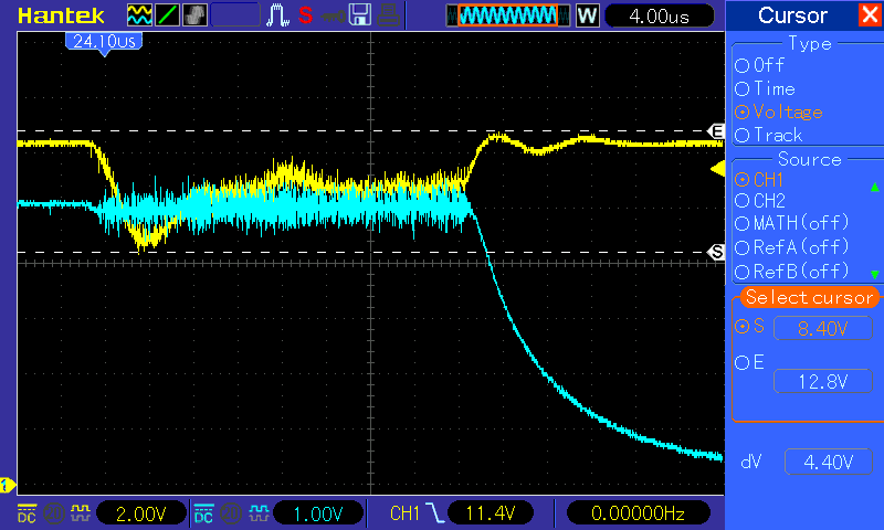

I'm trying to diagnose a frequent failure of a TPS62133-based circuit. Testing shows that the circuit causes the switcher to fail frequently, but not always (i.e. there are some instances that appear to survive forever.
I have narrows it down to a sudden load transient when the input is 12V or more. This condition often occurs as result of switching on a load that does not have proper in-rush current limiting. My understanding of the datasheet is that the '33 should be protected against load over-current and short-to-ground.
Here is a capture of the input and output of the switcher during such a failure. In this case, I'm switching about 0.5ohm load (which is expected to cause the current limiting to activate, but not to fail the switcher).
Yellow is input (nominal 12V) and cyan is output. It is evident that  the Vin ratings are maintained and the failure occurs after around 30[us].

  • Does this only happen when the load transient is seen with 12Vin or higher? i.e. it does not occur when Vin is 11V? What sort of input source is it? It has a fairly high impedance to drop that much in your waveform.
    I've increased the input voltage gradually and have only been able to make it fail at about 12V. Input source is a bench Power supply. The high impedence is mostly a result of long wires and connectors. This was done deliberately in order to simulate worst case inrush ringing although it is irrelevant in this test.

    Is your testing at room temperature? Do you have a current probe available?
    Can you explain in a little more detail what you mean when you say the IC fails? Vout clearly goes to 0V, but if the load is removed and/or the IC restarted, does Vout come back up? Does the IC get hot without a load after this test?

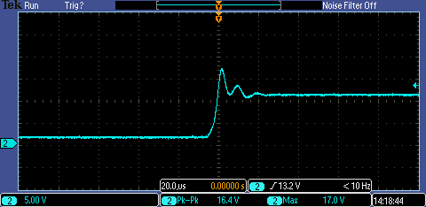

    Could you take a waveform of Vin on the TPS62133 as the 12V is applied to your system?

    I do not have a current probe available, but could probably get one. Probing the inductor current would be hard and very intrusive but probing the input and/or output current should be quite easy.
    When I say fails, I mean becomes and open circuit irrecoverably. It does not get hot nor consume any current, but fails to output anything long  after the load has been removed and the input cycled.
    Attaching a Vin waveform for an earlier test. Note that there is a simple protection circuit on the input that doesn't kick in in this case, but would clamp the input if it exceeds about 18V. We have verified that even in the presence of higher input inductance and input voltage the voltage is correctly clamped and never exceeds the maximum rating of 20V.
  • A spike that high on Vin seems a little worrisome for fear that tolerances, etc. could make it higher. It would be worth trying to add more input capacitance on the PCB (like a 100uF tantalum) and see if that spike magnitude is reduced. Then, with the reduced spike, see if it still fails during the load transient.
    Otherwise, yes, I would need a waveform of Vin, Vout, SW, and the inductor current at around 5 usec/div when it fails. Measuring the inductor current isn't intrusive electrically. All the graphs in the datasheet were done this way: remove the inductor and solder it to the SW node on one terminal; then put a wire from the other terminal to Vout and clamp the current probe there.
    As I mentioned, there's a protection circuit that hard-clamps around 19V. As you can see from my original graphs, there was no spike recorded during the failure. I have done a lot of testing with toggling the input and have not managed to damage the TPS, so I don't think this is a concern in itself (unless you think it may suggest something else).
    Intrusive in the sense of having a substantial impact on the layout and adding resistance between the inductor and the output cap, which is inside the feedback loop. I'm waiting for replacement parts to arrive and I'll try to produce those graphs. What are we expecting to see? What might be the possible causes for failure given what we know? Is it possible for me to send a few samples to TI for an engineer to look at?
  • I'm not suggesting that spin the PCB to add the wire. Just do it by hand. The minimal added resistance is not important.
    This is the standard waveform needed for debugging. It will tell us what the IC doing, where the currents are going, etc.
    If you have a local FAE, he or she would be an excellent resource to debug with you on the bench.
