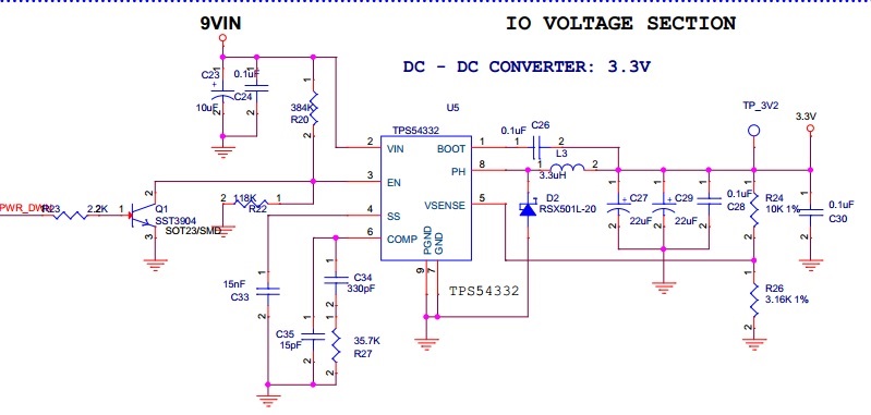

We are using TPS54332 generate 3.3V in the baseboard. when we power on the baseboard and check the output voltage of TPS54332 is 3.34V. but when we put our module into the base board the voltage drops to 2.0V why this is happening ? is the TPS54332 is not able to supply the sufficient current to the module ? the module requires hardly 350mA in 3.3V rail.
 The module works without an issues if we power up the module with desktop power supply.
here
i have attached the schematics portion of the TP54332, please let us know what would the reason for this behavior.
No load : 3.34V
with load : 2.0V
