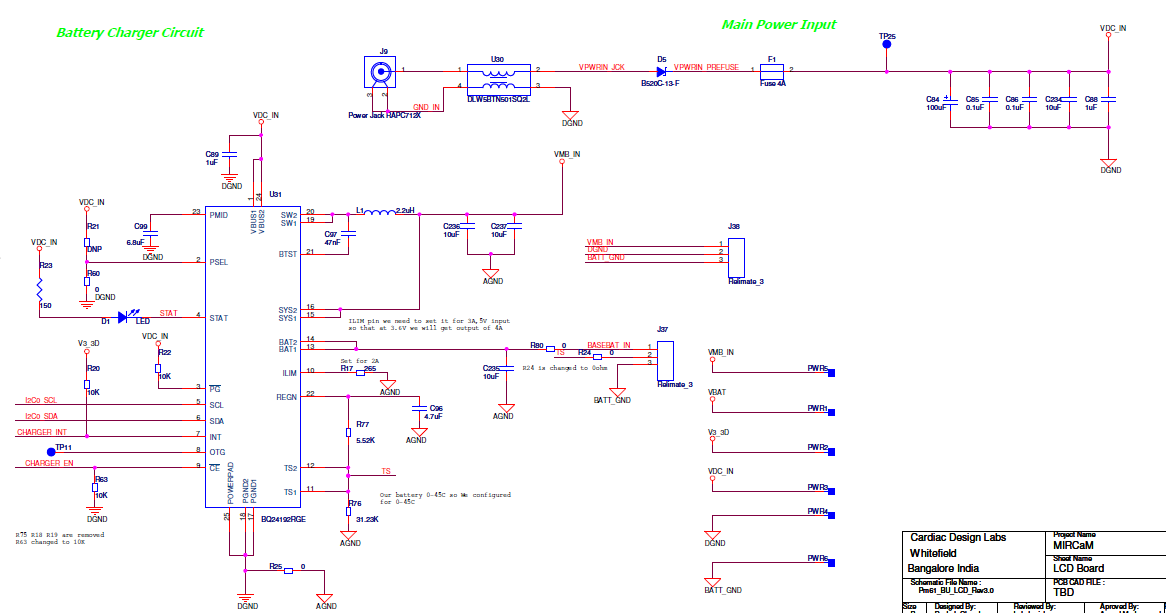

Dear All,
             This is Bhairu from Cardiac Design Lab.
              We have two design ALPHA & POC. We have used  BQ24192 in both the design.   The battery is not getting charged when device is ON, However same is getting charged when device is OFF. We carried out the same experiment with Alpha design & same battery, battery is getting charged even though device is ON or OFF.  The Bq24192 schematic and testing results are as below.
Fig: BQ24192 Schmatic
LOAD status Charge Status Design Adapter
voltage(V)
I/P current Load current Battery
current(A)
Charging
current(A)
Disharging
current(A)
Remarks
LOAD ON Charge ALPHA 5 1.66 1.576998 0.083002 0.083002   I/P Current = Charging current + Load current
Here battery is charging
9 0.98 0.898604 0.081396 0.081396
12 0.76 0.682531 0.077469 0.077469
POC 5 1.06 1.126426 0.066426   0.066426 Load current = Input current + Battery discharge current
here battery is not charging.
9 0.63 0.644458 0.014458   0.014458
12 0.48 0.501598 0.021598   0.021598
LOAD OFF Charge ALPHA 5 0.59     0.717567568
9 0.35     0.766216216
12 0.27     0.788108108
POC 5 1.15     1.398648649
9 0.67     1.466756757
12 0.52     1.517837838
Table: The testing results
So anyone suggest me what could be the issue is. Please reply me at the earliest.
