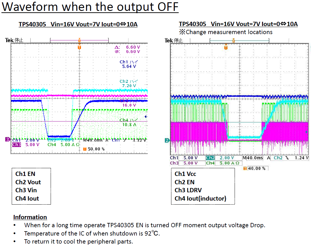

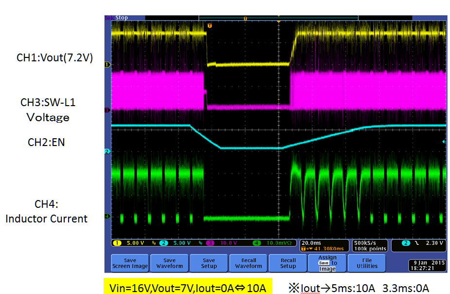

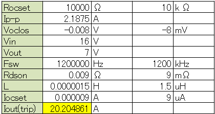

Our customer is going to use TPS40305 in attaced conditions .
I suspect the short-circuit protection or thermal shutdown.
Is there a protection operation EN is Low of TPS40305 ?
Please tell me the cause of the operation, such as the waveform.
