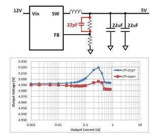

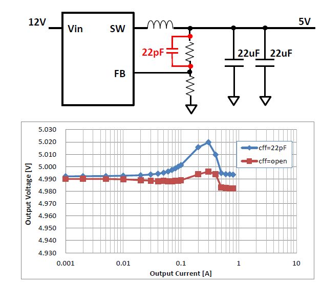

Customer has a question about load regulation.
Output valtage of TPS54528 is inceased at translatoin from  DCM to CCM and it's depends on sample.
One is 30mV and the other is 6mV between 1mA and peak.
Customer would like to know the reason why is different between sample and sampleand what is the root cause?
On time is different and therefore ripple is also is diffrent, but I don't know why it effect  peak voltage in load regulation.
Could you please that mechanism?
Please take a look an attaching file.
