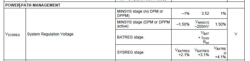

  • How SYSREG will be maintained at the output when fully drained battery is connected.
    • What is the Min SYSREG output voltage? In datasheet under power path management section it is mentioned that the VSYSREG voltage will be MinSYS-200mV[3.5-0.2=3.3V]. Is that correct ?

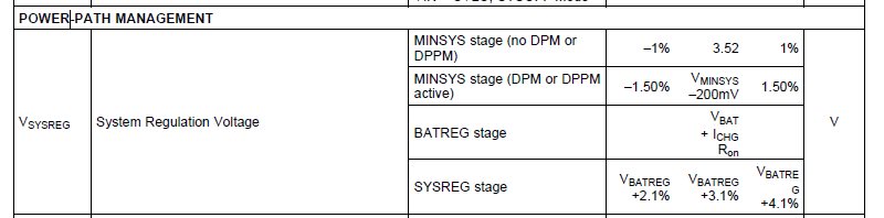

    [Sling_7thJan2015]: BATT voltage, SYS voltage and input voltage are as mentioned below.
    BATT Voltage = 3.12V ; SYS Voltage = 3.32V ; Vin = 5V
    EN1 and EN2 are configured to draw not more than 100mA from input[which will be the maximum current we can draw from 5V rail before enumeration].
    During this test no additional load is applied at SYS output.

  • In the spec that you attached in the first post, please notice that in MINSYS stage (DPM or DPPM active), the system voltage will be regulated at VMINSYS-200mV which is 3.3V as you observed.
    DPM loop will be active when the system and battery is trying to draw more power than what the input can provide, so the DPM loop will reduce the input current to prevent the further drop of the input voltage.
    DPPM loop will be active when the charge current is higher than the input current limit.
    If either of the above loop is active, the system voltage will be VMINSYS-200mV. In your case, because ILIM is limited to 100mA, if Ichg is above 100mV, then the DPPM loop is taking the control and that is why you are seeing 3.3V instead of 3.5V at system.
    To be able to get 3.5V output, you can change the ILIM setting to 500mA or some other value that is higher than your programmed charge current, or reduce your charge current to below 100mA before enumeration.

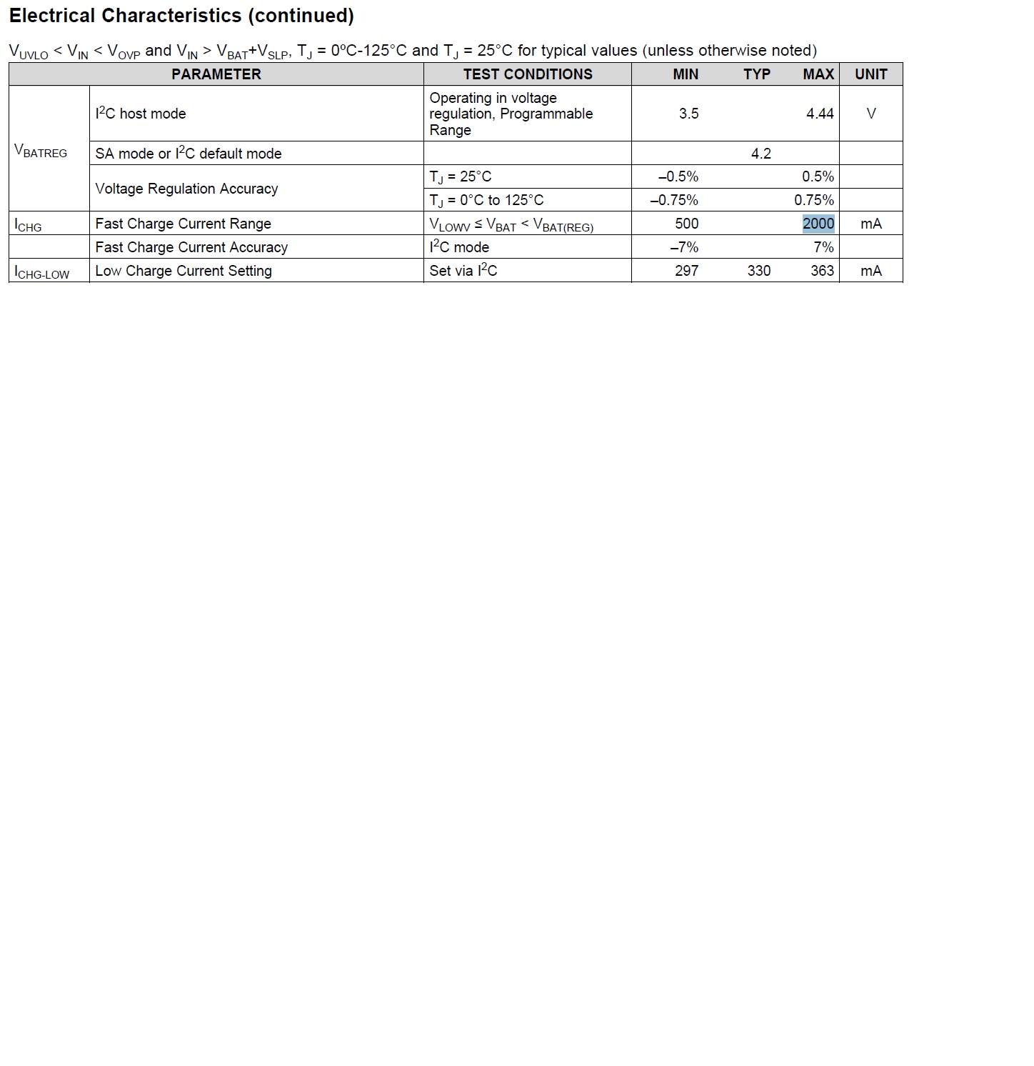

    It is good to know that we can set the charge current below 100mA in standalone mode.please let us know what is the min value we can set ?
    In Datasheet under Electrical characteristics why Fast charge current is mentioned as 500mA to 2A ?
    Vikram
  • Vikram,
    500mA to 2A is the recommended current range that we guaranteed with the accuracy on datasheet. In reality, the ICHG is linear with the resistor value on ISET pin and can be programmed to below 100mA.
