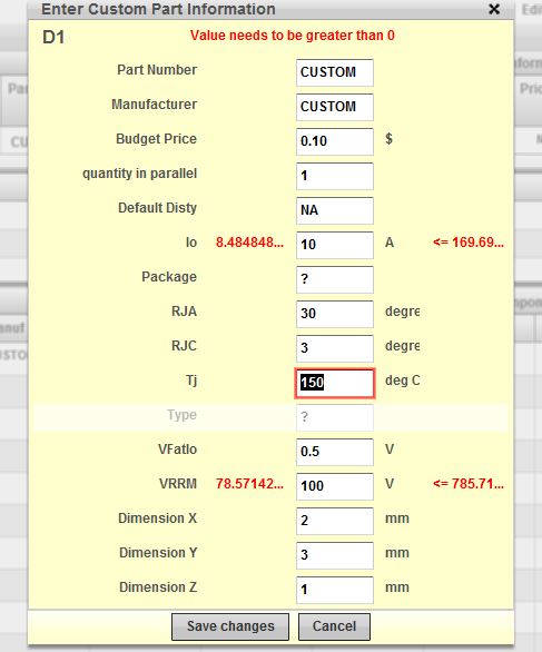

When design for LM5088 for:
Vin=50-55V
Vout=5V
Iput=7A
The design used a custom diode.and cannot be simulated corrected.
What can I do? In the eval board they use MBRB2060CT
Ideally you can use the MBRB2060CT diode given you have a very good layout. Here is a diode to be considered: STPS20M100SG-TR (100V, 20A Schottky).
Hi Eli,

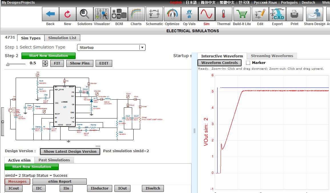

I was able to add the parameters to create a custom diode and to run the simulation in WEBENCH.
Please note that you need to fill in all the fields including the two key parameters; Io and VRRM need to meet the WEBENCH calculated range. The MBRB2060CT parameters works except for the VRRM value has to be >78V.
Here are couple of the screen shots the procedure above.
