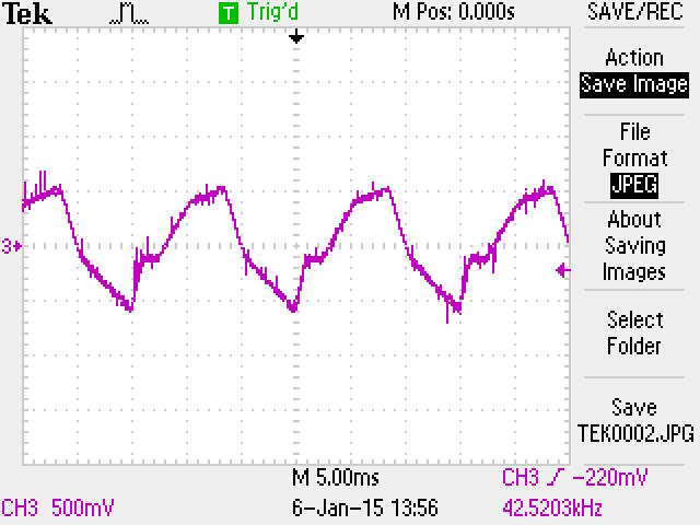

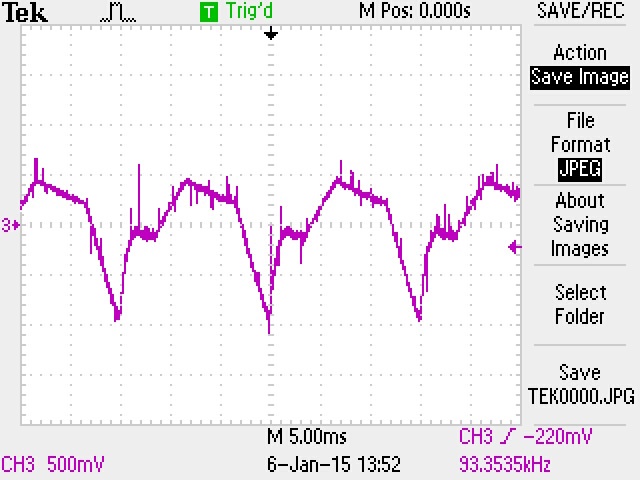

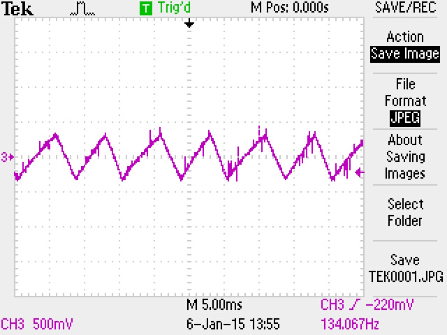

Here are few scope screenshots I made of the output voltage in AC mode:
On the image below the load was around 80mA.
On the image below the load was about 100mA.
On the image below the load was about 150mA
