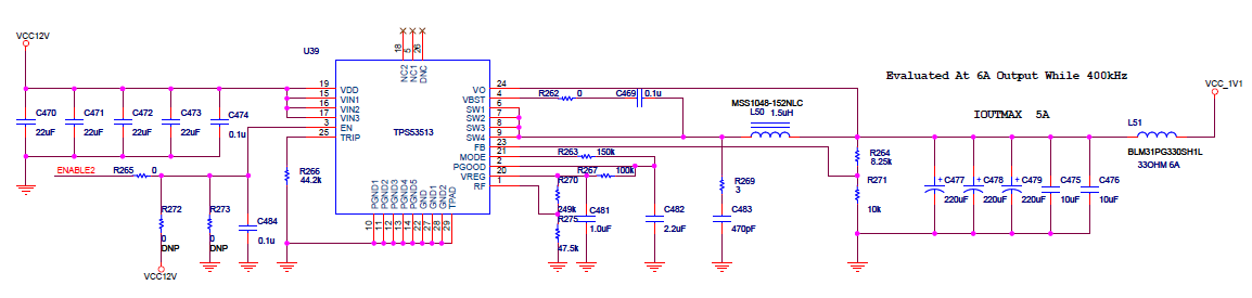

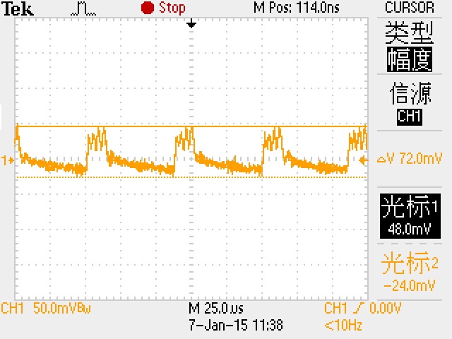

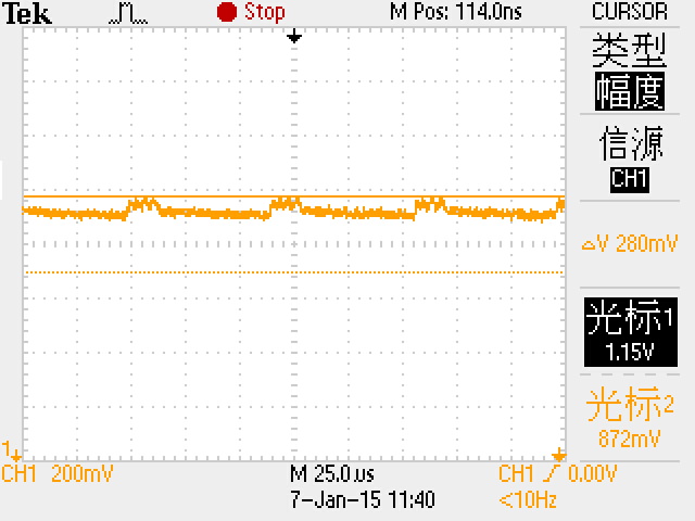

When I use TPS53513, the output have overshoot described in the following figure. Could anyone give me some help?
Thank you very much.
DC couple
AC couple
Schematic:

Thanks for your relay.
when i connect another 10uf cap at the output, the ripple chang from the sine to the wave show in the picture following when disconnect load.
(the dcdc freqency is 400kHz)

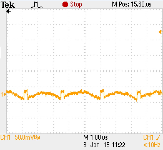

SW note wave. DC couple . disconnect load.(now i change the dcdc frequency from 400kHz to 750KHz)

Hi,John
Because I have not ever saw so serious periodic square overshoot in the ripple, i think there may some errors in the design.
Now,i chang the L from 1.5uH to 3.3uH and the square disapper and the ripple down to 25mv Vpp.
