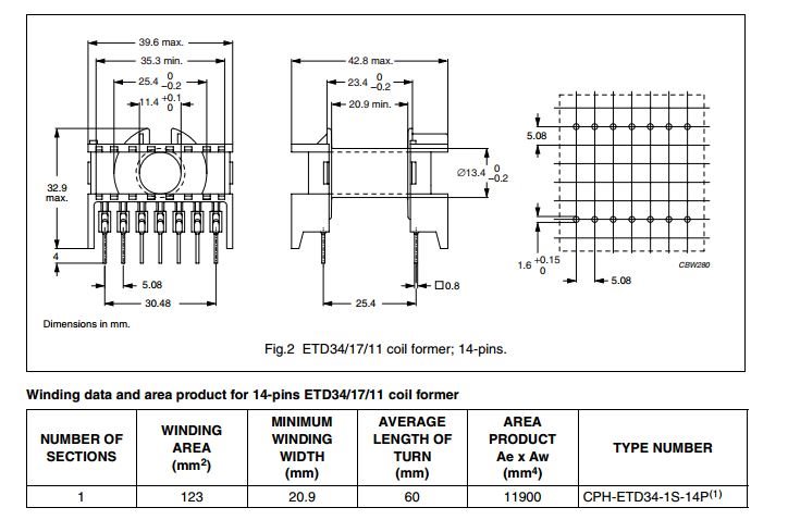

I am current working through the following document issued by TI
http://www.ti.com/lit/ml/slup126/slup126.pdf
How have they come up with the window area, breadth etc? Step 6

The window area, breadth, height and MLT(mean length turn) are all specified on the data sheet for the coilformer.
For example, I attached a page from the data sheet for the ETD34.
Window area is specified as 123mm2
The other parameters need to be calculated from the drawing for the bobbin geometry.
