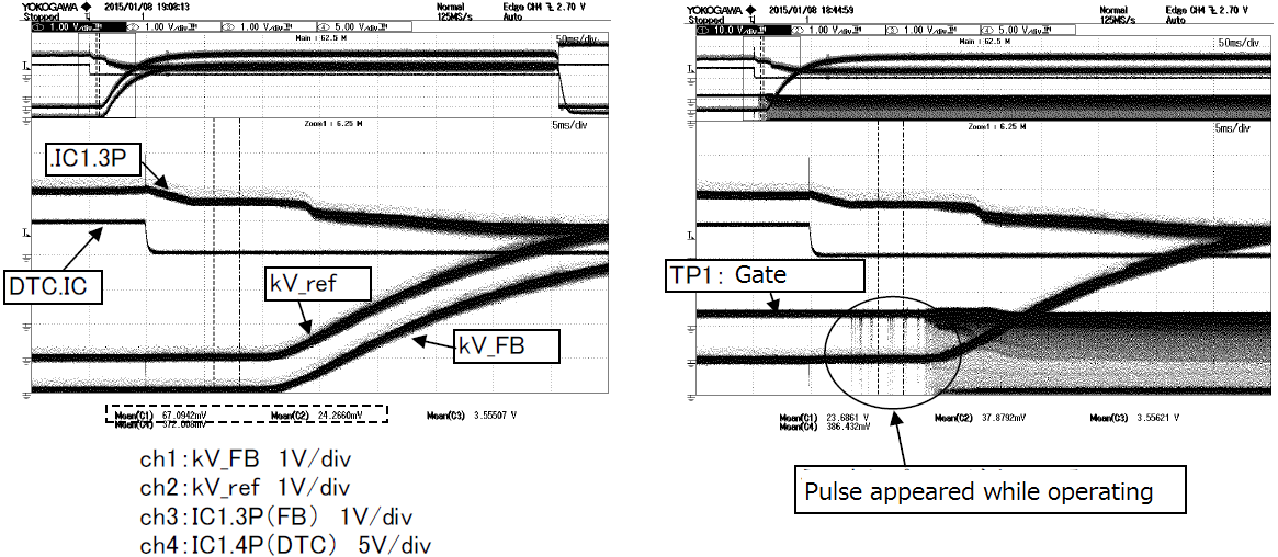

Inquiry regarding gate pulse on TL594
Other Parts Discussed in Thread: TL594
Hello, all
Now we have one inquiry regarding gate pulse noise on TL594 from our customer.
Please refer to the item below, and feedback us with your comment.
We are using this device for voltage control from 1IN+, 1IN- and FEEDBACK pins.
On this configuration, we found the gate pulse if applying 67mV into 1IN+ and 24mV into 1IN-.
The gain for "Error Amplifier 1" is set to 40dB.
Please also refer to the observed waveform as below;
We thank you in advance for your information.
