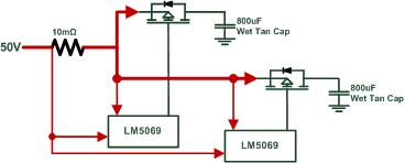

We have a design based on LM5069 as above.
The power limit is calculated and derated based on the MOSFET datasheet.
Please suggest whether this configuration will work or not.

    To answer your question, sharing the sense resistor like this can affect what you are trying to achieve. What is your application (input voltage range, current, total output capacitance). Most applications can get by with one controller in there system driving multiple MOSFETs if additional power is needed.
    If the current gets too high, both controllers will try to regulate, but not necessarily at the same time. Thus if they are driving separate loads, the loads will be unbalanced. For example, if we call it controller 1) and 2)... if 1) draws too much current on its load, 2) may begin regulating current first, lowering its gate voltage and reducing the of of 2). Then the current for 1) may continue to rise while 2) continues to decrease.
