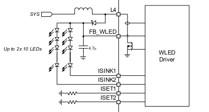

Dear support,
I'm working on a project who has a TPS65217 and now i need to use its WLED Driver to drive my LCD block (it has four parallel WLEDs and its interface is shown in the picture below). I have some questions listed as follow:
1.in the TPS65217's datasheet, each of ISINK1 and ISINK2  connects 4 series LEDs, but my LCD block has 4 parallel WLEDs, how should i connect the pins between tps65217 and the interface of WLED?
2.how to deal with the pin ISET1 and ISET2, just as is shown in the datasheet or ?
