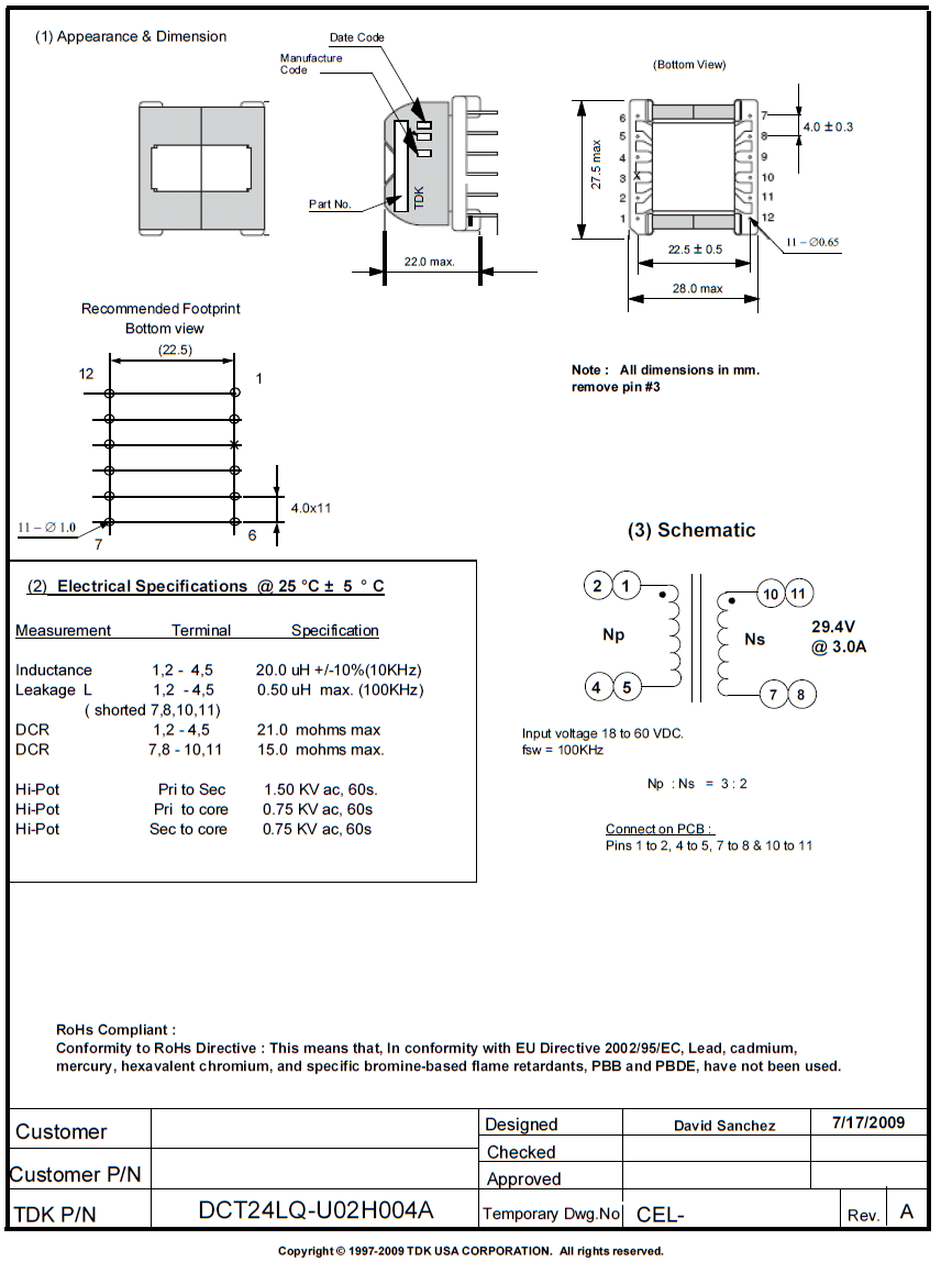

My customer want use TPS40210 reference design PMP6943, as the transformer DCT24LQ-U0XH004 is customized part, cold anybody advise how to get the transformer spec.
Hi Stone,
The specification I posted is the only information I have on this transformer. For these details I suggest trying to contact TDK who made the transformer.
Anthony
That's great. I may use the PMP7279 Reference Design, which uses the sam tranformer to bread board a similar design.
Does TI have a list of custom flyback transformers recomended to use with their reference designs?
The TDK Web Sites doesn't seem to post it.
