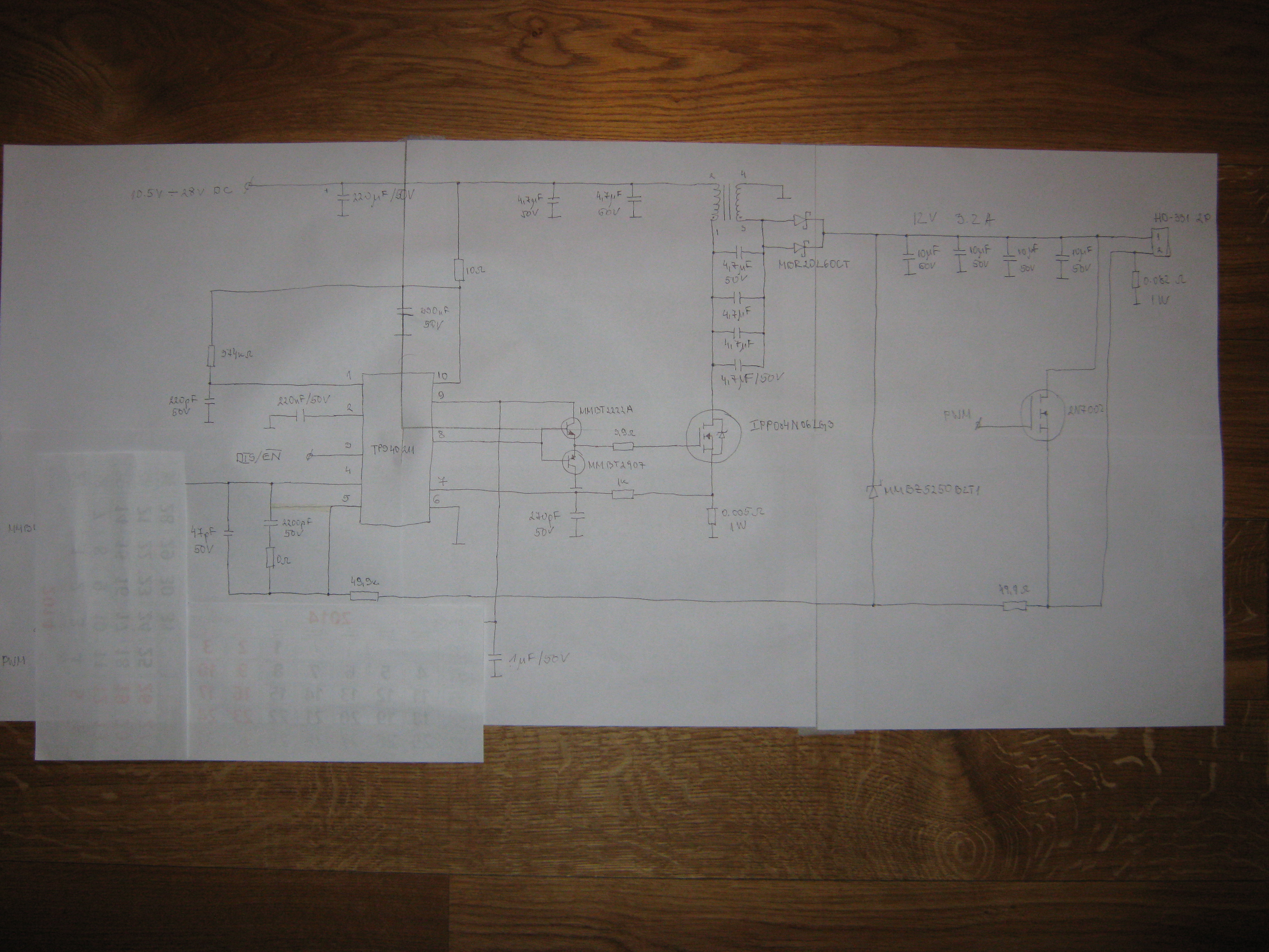

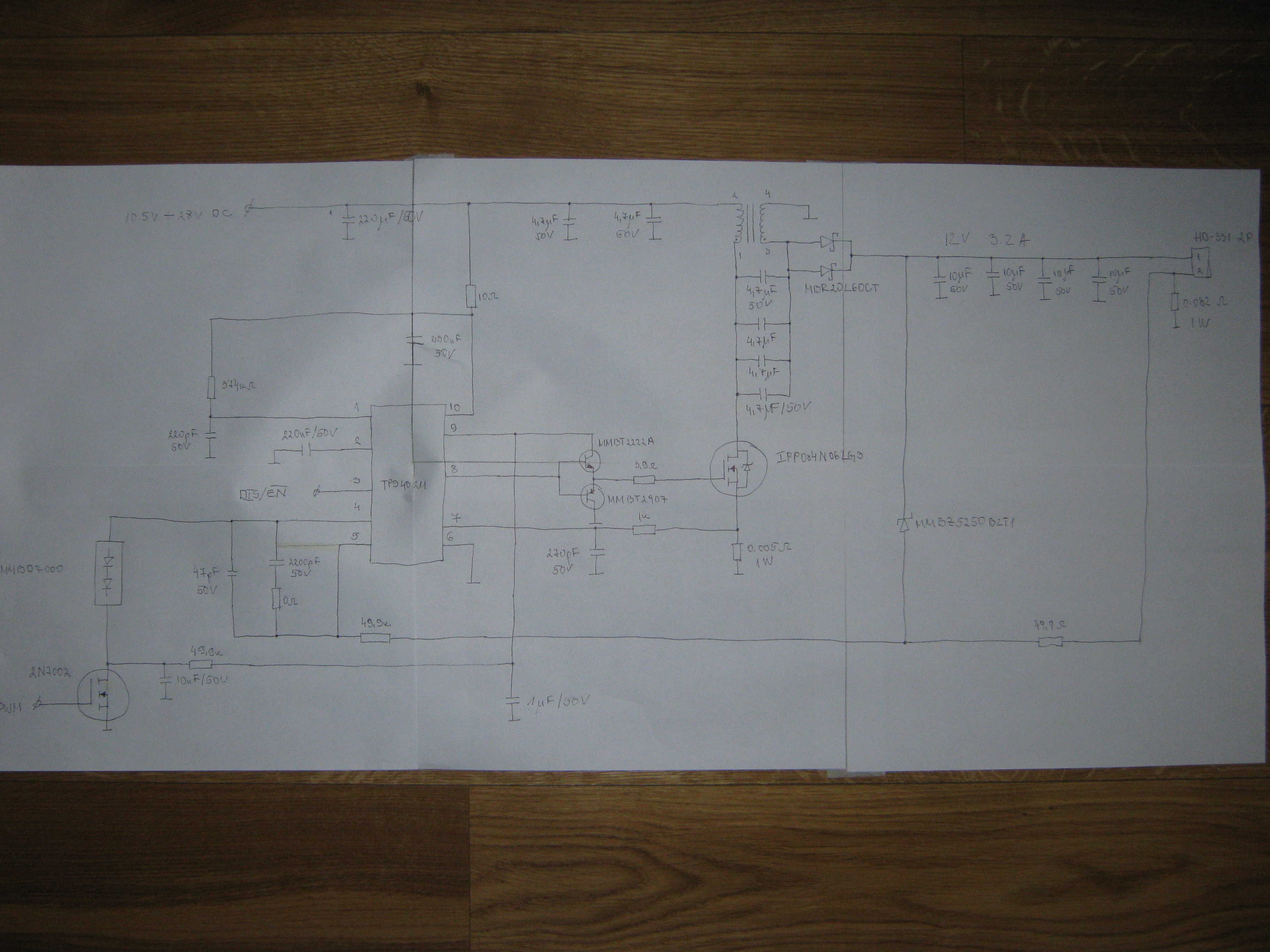

Basically, I want to drive a LED strip with the design proposed in PMP4702.
But I did a slight modification by adding a PWM capability. Please accept my apology for the hand drawing. That was just the easiet and quickest way to do it.
So I was wondering whether this would work or not? Am I missing something?
Any feedback and advice would be appreciated.
Kind Regards
Martin Botsov
  • Martin:
    Although this PWM dimming circuit is in the TPS4011 data sheet, it may not work well for this SEPIC design. If the PWM dimming frequency is low, you can do PWM dimming using the EN pin. If you do that, you have to reduce the soft start time. If the PWM dimming frequency is high, you can do shut FET PWM dimming by put a MOSFET in parallel with the LED string.

    If I have understood you correctly, your advice should practically look something like this.
    I've covered the initial circuit with a few white sheets of paper because I ran out of corretion tape. But basically I have removed the transistor, capacitor and the two resistors that I had put there at first.

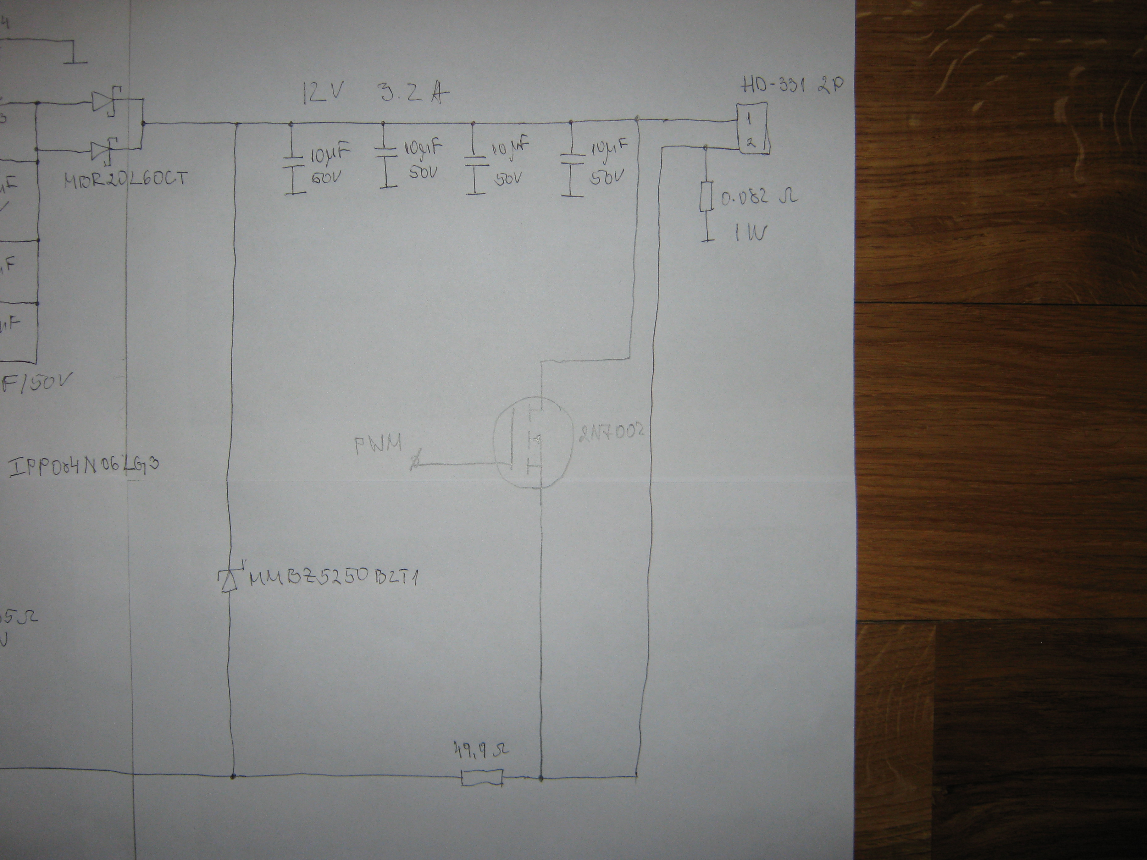

    Now, this is a close up of the output with the transistor in parallel to the LED string.
    It's drawn with a pencil.
    And that is the whole circuit.
    Have I understood your advice correctly?

  • Martin:
    The circuit is correct. 2N7002 is probably not the right MOSFET to do the dimming. It is a 300mA MOSFET.
    David Zhang

    Oh, yes. I figured out that this transistor won't be a good fit. But I had
    already uploaded my post and so I left it anyway. I picked up another MOSFET
    that can withstand those currents. So, I am updating the design first thing
    tomorrow morning.
    Martin Botsov
