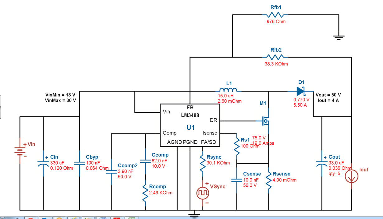

I am going to run it at 333KHz switching frequency, I have managed to get a 50V output but have a lot of oscillation on the gate of the MOSFET
Hi Doyel,
http://webench.ti.com/webench5/power/webench5.cgi?lang_chosen=en_US&VinMin=18&VinMax=24&O1V=50&O1I=4&op_TA=30
What i have managed to reduce the noise a little with a series gate resistor, however at around 12W the output is no longer regulated at 50V its is around 38V at 18V input voltage
Also there is some waveform jittering present at higher loads.
