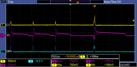

I am trying to push the limits of this little flyback, ideally I would like to achieve a 100W 12V output.  If this cannot be reached that is fine, but I need to get the controller to turn on so I can evaluate the limits of my circuit.  I have selected a MOSFET that can be turned on by the 25mA DRV pin, and I am using a non-dissipative snubber with the fastest diodes I could find (15ns trr).  I can provide schematic and board layout if that can help.
Here is the hangup:
The controller appears to to perform the startup operation described in section 8.4.4 of the datasheet, switching the FET three times with a short impulse. This can be seen in the scope capture below. It then looks as if it is trying to start up as it produces a DRV signal to the gate of significant duty cycle, but then returns to a reset procedure. The circuit behaves this way for a few cycles on startup, and then remains in a low power state where it just produces the initial three pulses with no significant switch following.
I initially assumed that the controller must be getting a bad measurement as my circuit had some ringing.  I have since improved this and verified that the CS and VS values are well within the limits throughout its operation.  Aside from placing high freq caps on CS and VS, does anyone have advice that can help me get this controller up and running?  What are the possible conditions that would create this behavior?

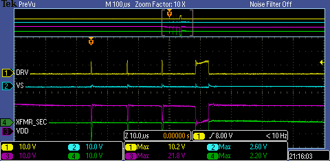

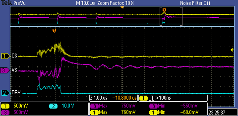

    I do have some new information about the problem, but now I am even more stumped.  I was incorrect in my earlier statement in saying that CS remained within the expected operating range during my testing.  I realized that I was probing not on the CS pin, but on the other side of Rlc.  I connected a wire directly to the CS pin and noticed that during the first DRV pulse the CS signal reaches the 1.5V reset threshold.  I suspected that my transformer was saturating, so I decided to increase the shunt to decrease the Iocc in order to start up the circuit in a confidently linear region of the transformer's operation.  I increased R6 (Rcs) to 1.5 ohm and R9 (Rlc) to 8.84k.  This should have set Iocc to around 1.75A, well beneath the saturation region of the transformer.  When I did this I saw that the first DRV pulse (after the 3 startup blips) stopped when CS reached 0.75V, indicating that the controller had correctly calibrated itself and should be in the CC operation.  Despite this, the controller still failed to turn on, and continued to repeat its reset sequence.  Below are some scope captures from this test.
    You can notice that when zooming in to this pulse, the signal looks pretty bad when DRV is high.  This may be measurement noise, as the frequency is much faster than any resonance I have measured on the board.  You can see by the initial rise of DRV that the gate capacitance charges quick enough, ~100ns, so I don't think the gate drive is the problem.  What are your thoughts?
