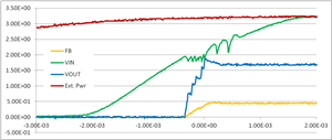

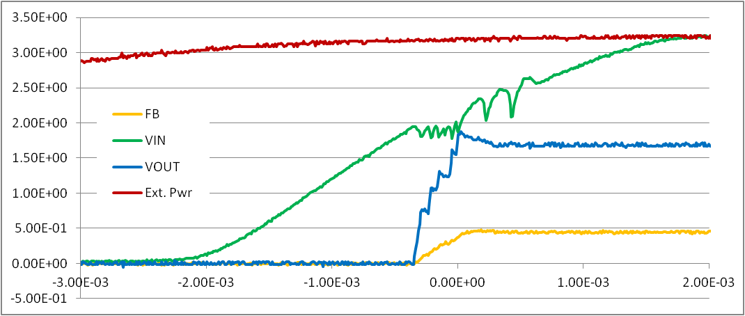

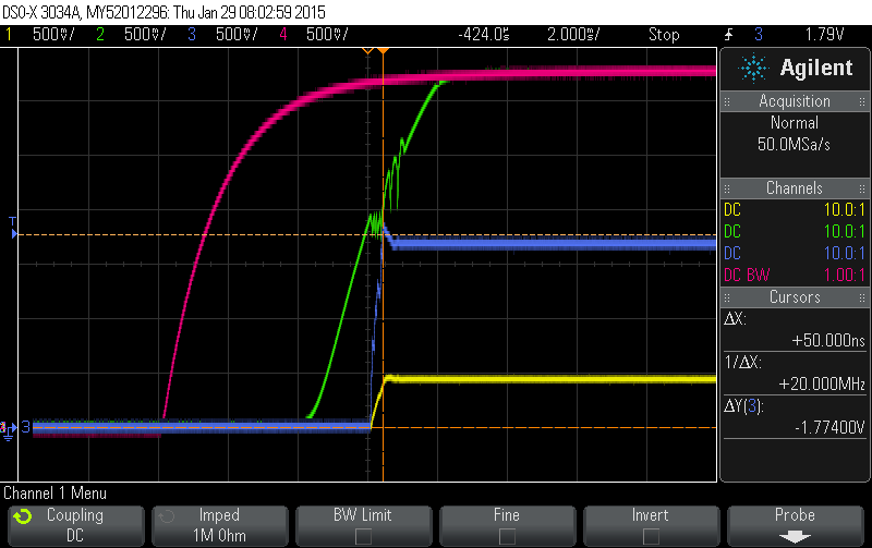

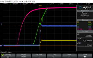

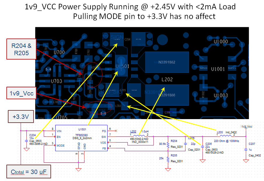

We designed this regulator to operate at +1.9V  (R1 = 80.6kohm, R2 = 25kOhm) on our board following the recommended circuit and layout in the data sheet.  When we initially powered up, this supply was running at +2.45V and FB was at 0.55V.  When I applied ~300 mA load (5+ ohms) Vout dropped to the programmed value and FB was 0.45V.
This regulator is supposed to work at LOW output currents so we expected this to operate at FB = 0.45V and Vout = +1.9V down to 2mA or lower.
Any idea why this does not operate lower?
