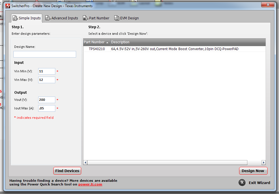

At first, I used Switcher Pro, and it said I should use the TPS40210, it was the only option showed:
The schematic is the following, I already builded it, but I can't get it working with the calculated components by Switcher Pro, I had to reduce the Soft start capacitor, and the Inductor, this way I get 200v but not 50mA output.

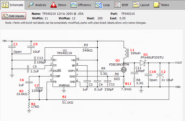

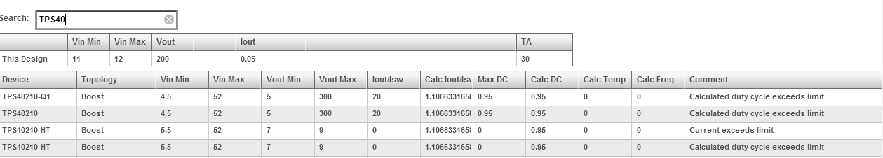

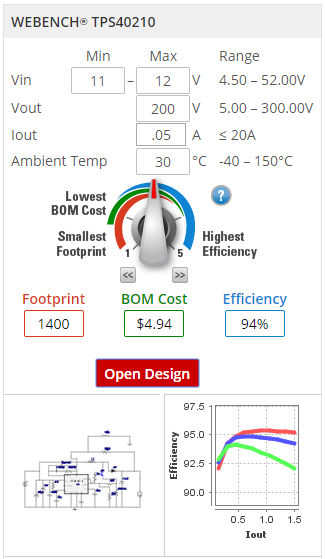

So I tried with webench tool, and it says that TPS40210 isn't suitable for my application: "Design cannot be created with this device. Please press OK and select a different device from the list Or click below to show why parts were not found."
If I look for the reason, it says that I'm exceeding the duty cycle limit.
SwitcherPro says the duty cycle with my parameters would be 94.6% max.

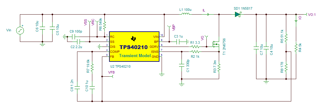

I made a simulation in tina-ti, with the values calculated by switcher Pro, and it works.
The diode and mosfet aren't the ones which dictated Switcher Pro, but I have changed it's parameters to match with the indicated components.

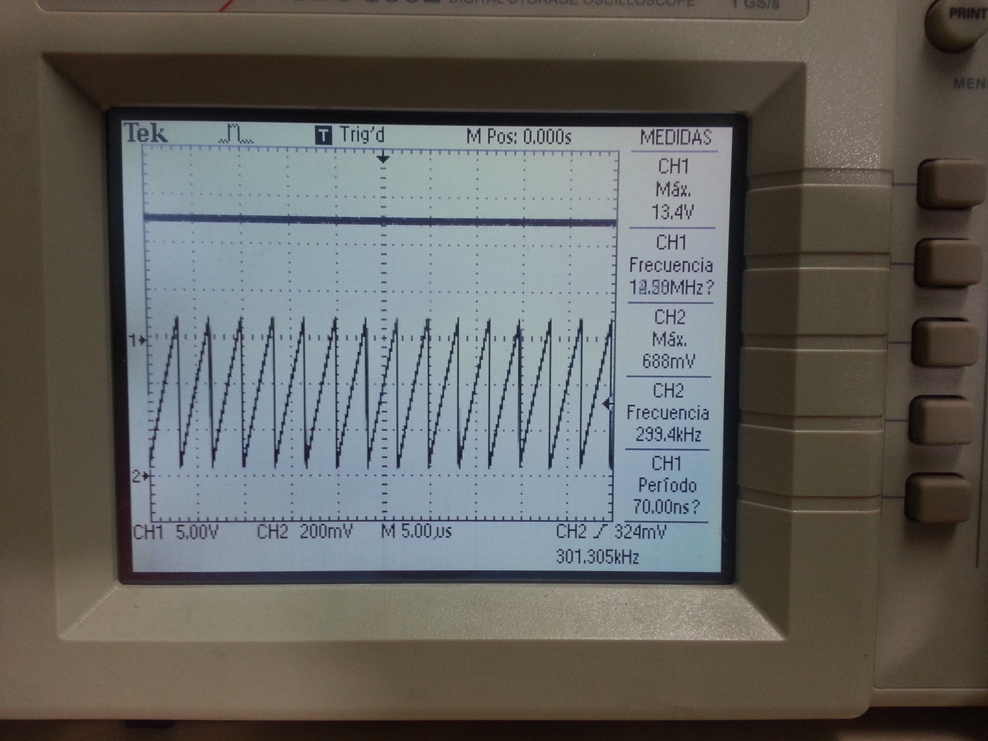

In my physical circuit, with the values suggested by switcher pro, the first thing I noticed was that the frequency was wrong, with 549k and 100pF I should have a 300khz, but instead I have the half, I measured this just connecting Vin, Gnd and the RC network, I measured the same with everything connected.
Should I multiply my Rc resistor in order to force the 300khz? If I just connected power supply and Rc circuit, what could I have made wrong? :(

Is the Webench tool correct when it says that TPS isn't suitable for my application?

  • Should I have 300 khz in the RC pin? Or is it correct to have 150 Khz and internally this frequency is multiplied?
    Because if I set a 300k ohms resistor I can have a 300 khz frequency at the RC pin, but I'm forcing this because it should work with a 549k ohms resistor.

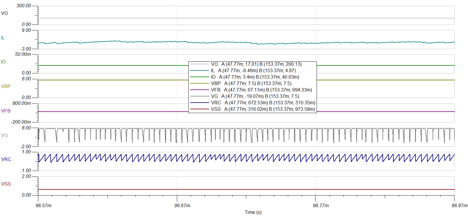

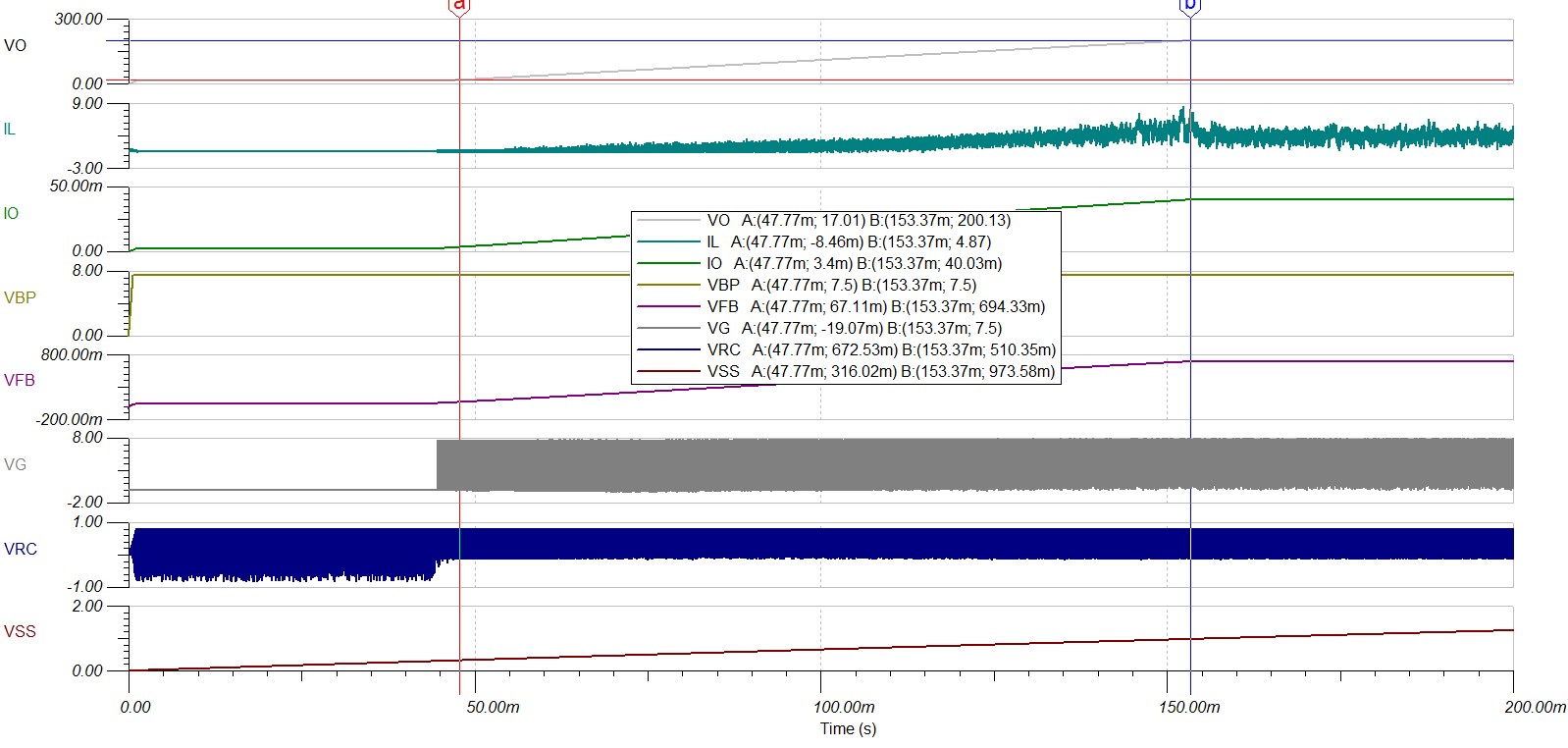

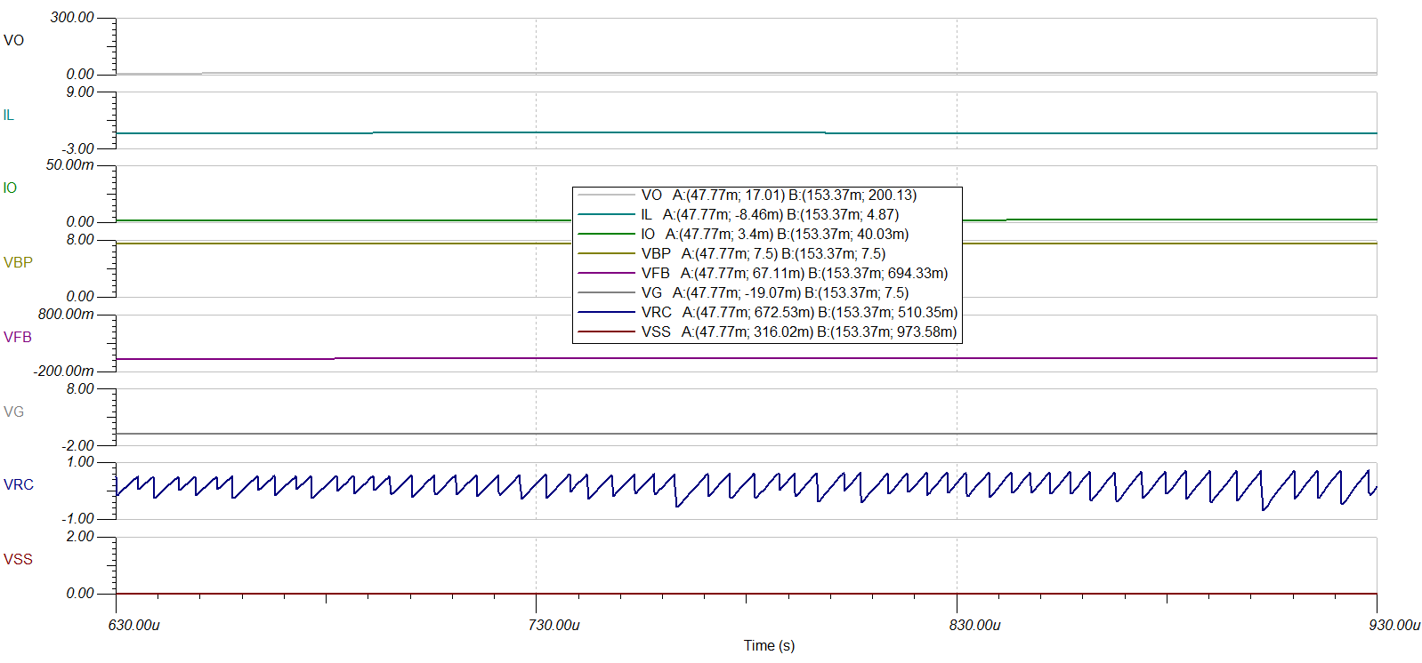

    Tina shows that I should have around 300khz in Rc pin, but also shows that at the start, while SS is charging it has 180 khz.
    Am I seeing the half of the frequency because my controller hasn't started yet?
    300khz with a 300K omhs resistor.
    Tina 180Khz at start
    Tina steady state with 300Khz

    To answer your first question, Webench is always preferred over SwitcherPro simply because Webench pulls from an active database of over a 100,000 parts each characterized and implemented within the platform. This allows you to have unique schematics with varying values which still work.
    The other benefit of webench is parasitics calculations which make the simulations and results more thorough. Tina TI or Switcher Pro are not lying when they say that this circuit will work, but because they inherently make approximations, edge operating conditions are far less accurate because there is no wiggle room for approximations.
    What I mean by this is any operating mode that pushes the IC towards the datasheet limits will be incorrectly simulated by any software save for Webench.
    In your case, the duty cycle has far exceeded 94.8% due to parasitics. Hence the IC keeps resetting itself as it tries and tries to deliver what you are asking it to do.
    Attached is a design that will work for your application:
    8865.E2E - Jose - Flyback design for 12V to 200V.pdf
    Let me know how I can be of further assistance.
