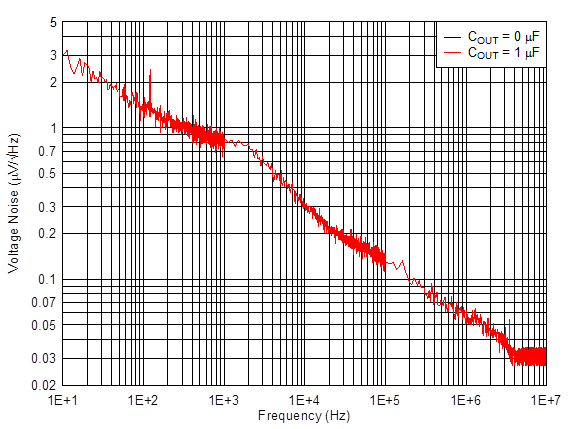

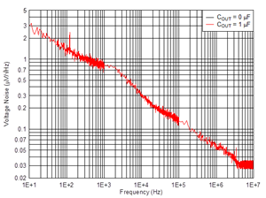

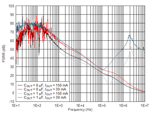

Hi all.
TLV713xx has the benefit that it will behave to stable even without an output capacitor.
But I think that the output voltage noise and the transient response become better if we use output capacitor.
In addition, there is no the comparing data in the data sheet of TLV713xx.
Could you give me the reference data that I can compare the characterisics of using capacitor and without using the capacitor?
