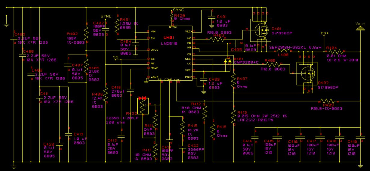

Hello
I'm using the LM25116 at the heart of a small 2A out regulator, the output voltage of which has to have some flexibility depending on an injected input voltage. I made the voltage variable in two ways. First I used a pot R432 (R411 is in parallel but it is not populated on the board) the pot ideally would let me set the inital highest voltage, and then I could inject a voltage below 1.215 volts into the SS pin to lower the voltage even further for my application. Now my problem is this, no matter what value I set to the pot or the voltage I inject into the SS pin the voltage is always a constant around 6V. I've worked on this for a little bit and have not been able to figure out the problem. The eval board I first modeled this circuit on works, and I am at a loss at the moment for why this is failing. Below is a copy of my schematic
Edit: 2014/02/05 3:58PM EST
