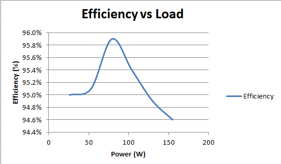

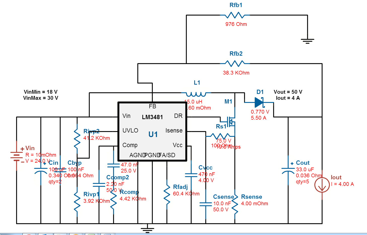

I am currently using the design that was simulated in the WeBench software (attached). I have used every item in the BOM and have taken the LM3481 demo board and have changed it to the components in the design. When I go into the higher loads 100W+ the efficiency drops. Is this because of the diode losses? What can I do to overcome this issue?
