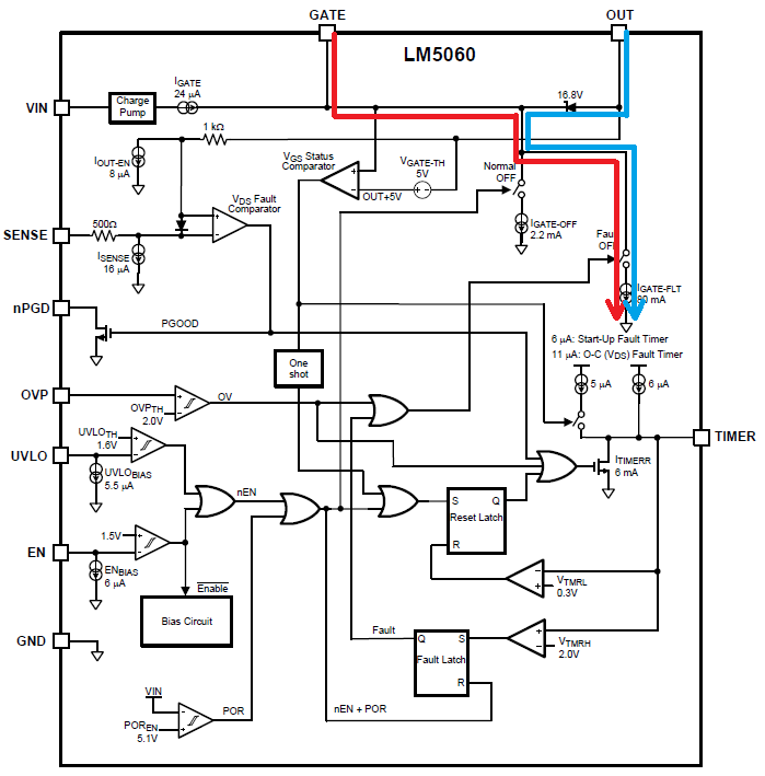

I'd like to confirm about OVP function of LM5060.
If the OVP pin voltage is higher than the OVPth threshold, I believe OUT pin is discharged via forward direction of zener diode.
*OUT pin is discharged same as GATE pin.
Is my understanding correct?
