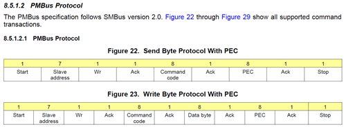

Customer will be able to collectively manage the I2C control IC and PMBus control IC?
Should customer to be prepared individually Bus line?
Please let me know if there is documentation on PMbus.
Yusuke/Japan Disty
  • The two TPS65xxx devices are both PMBus so they should have no problem co-existing on the same communications link.  PMBus was derived from SMBus which is a superset of I2C.  Many I2C devices can be placed on the same bus as PMBus devices.  I am not specifically familiar with these devices.
    General PMBus specifications can be found here:
    http://pmbus.org/Specifications/CurrentSpecifications
    Device specific PMBus information such as supported commands and definition of any manufacturer specific commands are usually documented on the product page.
    If EVMs are available then I might suggest that the three boards be daisy-chained on a single cable and see if you can successfully communicate, I suspect the answer is yes if the host has the capability to communicate to both protocols.
  • Hi Brad,Thank you for your a information.Best Regards,Yusuke/Japan Disty
  • Hi Brad,

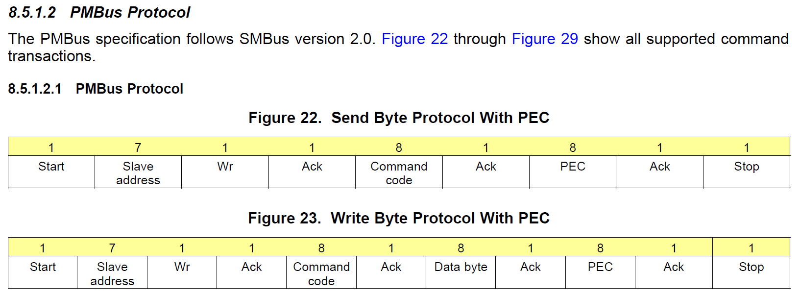

    Could you tell me about LM25066 and TPS53915 protocol.
    Is there a protocol table like TPS65400 data sheet page 36?
    If so, please tell me the document of PMBus protcol table.
