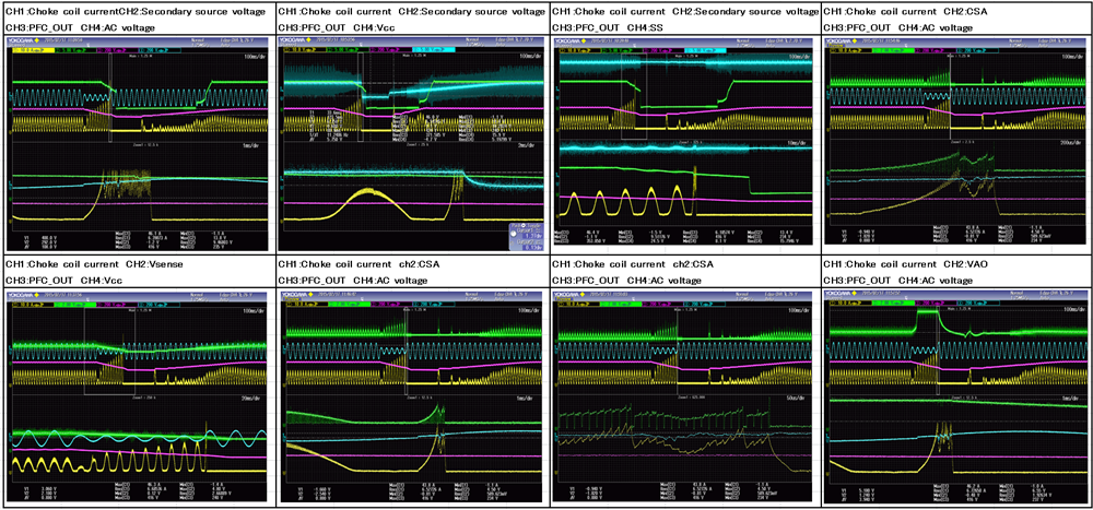

Customers running 5 cycle operation of the AC100V to 40V.
At that time restart of device occurs.
I will attach a waveform of when the problem occurred.

  • I spoke to one of my colleagues and he had this suggestion about what was going on:
    "The PFC cannot support the load with 40Vac input.   You can see the inductor current increasing and PFC OUT holds up for a few cycles, then starts to droop.
    The current increases to the point where it hits PKLMT and it suddenly gets all distorted into a noisy hash (because we don’t have slope compensation for the peak limit case).   VCC is NOT turning off, as seen in screen shot 3 (top –row, mislabeled as CH4:SS.. SS is in screenshot 2, mislabeled as CH4:Vcc) so that is not the problem.
    But as PFC OUT is falling, so is VSENSE.  It is not clear in these photes, but I think VSENSE has a lot of noise on it, and when it falls low enough, the noise from the PKLMT hash is getting in on the VSENSE and tripping the 0.75V/0.60V VSENSE comparator, subsequently tripping the Restart latch.
    This shuts down the system, until VAO decays to 0.75V a few-100 msec later and the ZeroPower comparator clears the latch, allowing restart."

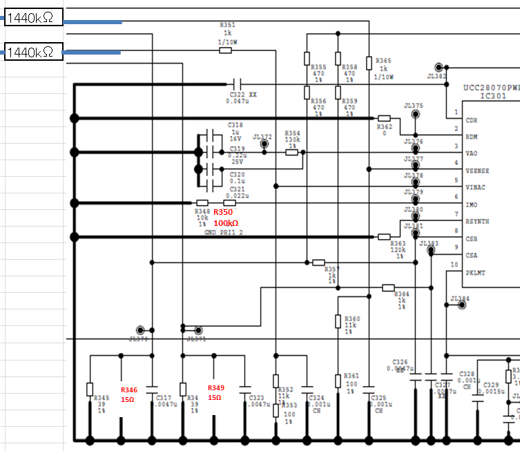

    Can you please send me a copy of the schematic so that I can check what filtering is used on the VSENSE  input?
  • Hi Jhon,
    Thank you for your support.
    I attached Vsense around circuit.
    Could tell me some advice.
    Yusuke/Japan Disty
  • Hi John,
    Thank you for your a support.
    Customer has been improved the problem by changing the layout..
    Yusuke/Japan Disty
