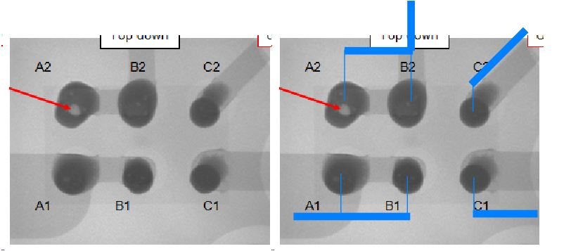

we recently are having problems with the solder quality for the TPS2291CYCPR devices. Because these devices are very small we are finding the devices are not maintained in a parallel position relative to the circuit board during solder process, resulting in gap difference.  I think this then results in a different temperature and melting of the solder resulting in one or more of the BGA not properly soldered.  Has anyone encounter similar issues with this device and what were the solutions.

  • Hi Michael,
    I have a few questions regarding your issue:
    1. Is this position error due to placement or does it happen during reflow?
    2. Would you be able to send us any pictures or x-rays of the problem so we can see exactly what is going on?  Any GERBER files of the PCB layout you might have would also be helpful.
    Alek Kaknevicius
  • Hello Alek
    Issue with soldering of the BGA was brought to light with a recent failure of the TPS22921 part.  In the analysis it was observed that two of the 6 pins showed power solder joints.  I am looking to see if there are any specific requirements on how this part should be soldered to a board base on its physical size and the 6 BGA.  My theory is that when placed on a board prep to solder, the solder paste may not be even and the melting of the solder past my not be event.  This results in the part tilting as the solder melts resulting in one or more pins not obtaining good solder joints due to a change in gap distance.
    Pictures:  AttachedPoor solder joints.docx
  • Hi Michael,
    Thank you for the x-rays and pictures, the issue is much clearer now.
    Based on the x-ray, it seems as though the metal between all 6 bumps is uneven.  What I mean is that there are larger traces on bumps A1 and C1, and this will cause the package to tilt away from the "2" side and towards the "1" side during soldering, creating opens on the "2" side.
    The below picture on the right shows the proper way to bring traces to this type of package.  The traces connecting to the bumps should be no thicker than the bump diameter itself.  This places the same amount of metal on each pad and balances the way the solder spreads during reflow.

  • Michael,
    To expand on what Alek just wrote, on the illustrations above, the traces need to be no wider than the recommended pad diameter until they clear the soldermask ring (plus allowance for soldermask registration) and then can be widened to any desired width or connected to a plane.
    An alternative is to use soldermask defined pads, where the metal is larger than the soldermask openings for all pads and the soldermask opening diameter (namely 0.225 - 0.23mm) defines the soldering pad. Metal pads should be made larger than the soldermask opening to allow for soldermask mis-registration. This approach makes all pads exposed to soldering the same size regardless as to how you connect your traces to the pads.
