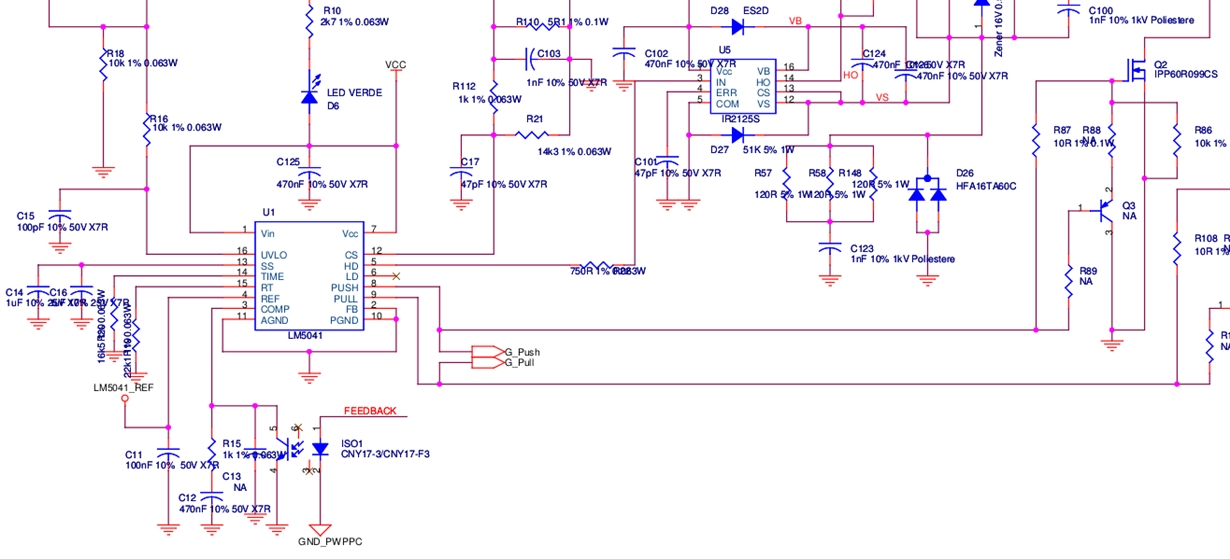

I've selected LM5041 in 2005 for a wide DC/DC power converter: 16-150V input, multiple isolated output for about 150W.
The scheme is very similar to evaluation board with some little difference: a diode instead of low side mos for the step-down, and a linear regulator for VCC and VIN pin without an aux return by the switching stage.
In this 10 years more that 90% of issue on this ECU (that include microprocessors, PLDs, and many digital/analog input/output) was from the LM5041 failure. In most cases I was found the IC in short circuit in most of pins whit all other components in regular working conditions.

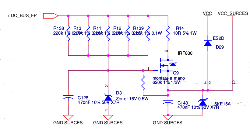

    The Vcc comes from Q9, is that right? Is there anything else damaged when the LM5041 fails short, power stage components, gate driver?
    Peter
  • Yes, Q9 is the voltage regulator for the startup. After the first stage (step-down) another voltage regulator (same scheme as Q9) provide for the Vcc from 16V of step-down.
    When I found LM5041 in short cirquit was enough to replace it to have the power stage in working condition
  • The max voltage rating for Vcc is 16V, is it possible that transient load on the system can casue the Vcc rail to exceed 16V. Have you looked at the VCC rail across the IC under abnormal operaing conditions to ensure the linear regulator and zener diode maintain the DC at less than 16V? Are there any voltage spikes on the rail due to switching currents from the gate drive outputs.
  • Vcc is regulated at 12V. I have never found voltage over 13V in all functional condition.That solution is to prevent spike on Vcc for possible switching controller issues.
    What do you mean with "abnormal"?
    Gates seem free from current reaction on push and pull, never replaced the IR2125.

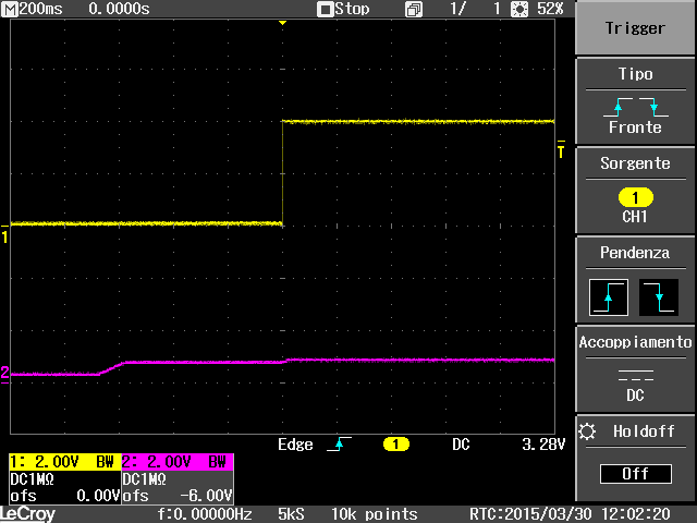

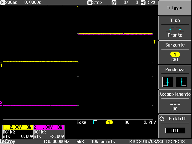

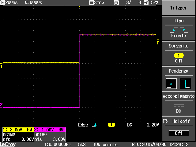

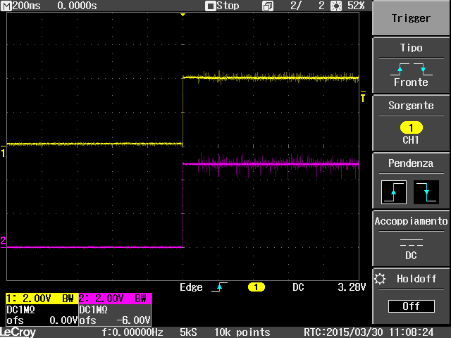

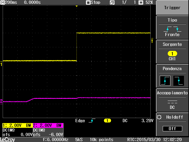

  • Hi Peter,

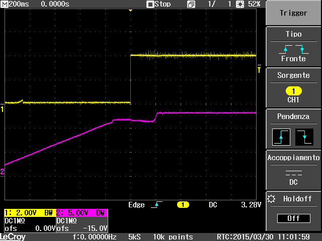

      these are the record of the signals. I've a 2 ch oscilloscope, than I've syncronized all the screens whit the UVLO signal (a power-control release UVLO after complete charge of input capacitors, than that is the natural sync).

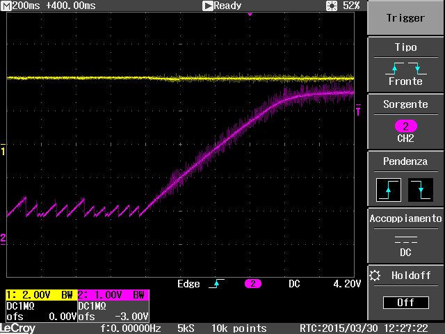

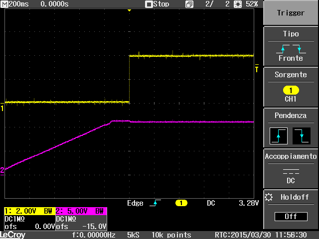

    At 20°C (in LM5041 zone) switching regulator work fine:
    Vcc@20°:
    after the charge of capacitors the Q9 supply with little less of 12V, than (after switching start) auxiliary's regulator supply with little more of 12V

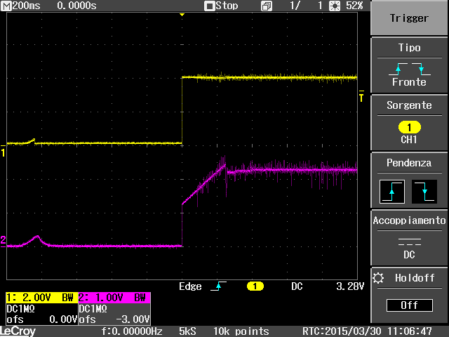

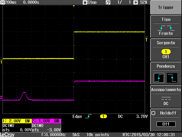

    COMP@20°C:
    at UVLO release, it go up in a ramp and "stop" when feedback intercept the target output

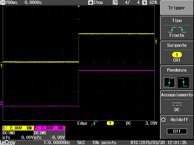

    REF@20°C:
    at UVLO release, it go stable at 5V

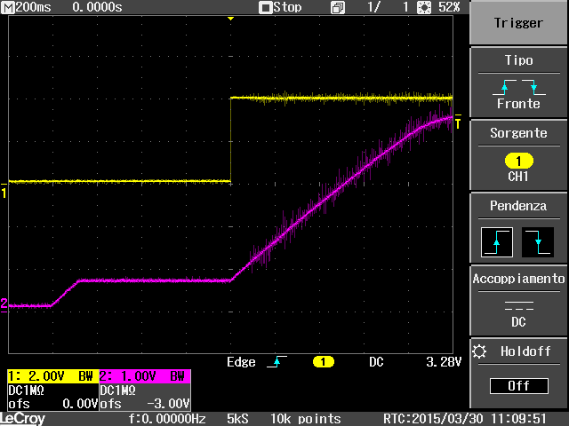

    SS@20°C:
    before UVLO release: ramp and still to 0,8V
    after UVLO release: free going up

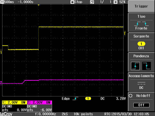

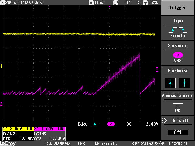

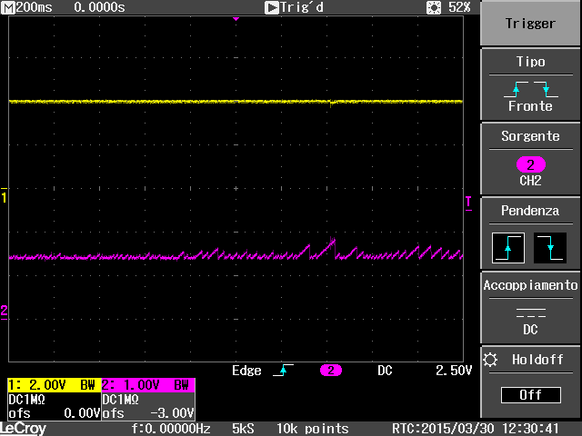

    At -1°C (in LM5041 zone) switching regulator don't work (don't start-up, or if it's going it stop):
    Vcc@-1°:
    COMP@-1°C:
    at UVLO release, it go to about 1,25V and still
    REF@-1°C:
    SS@-1°C:
    after UVLO release: it's locked to less than 1V

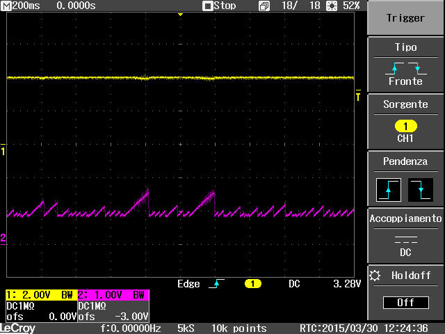

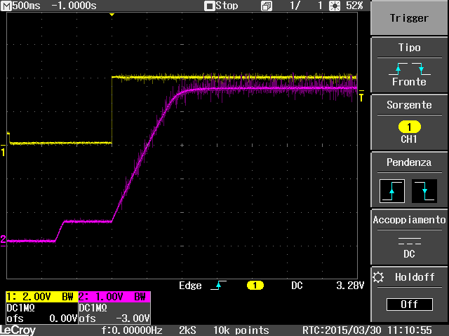

    At 1°C (in LM5041 zone) switching regulator don't work, but after many failure it start successfull. Interesting signals are:
    COMP@1°C:
    after few moments (don't look at the time in the bottom, because I restart the unit after every screenshot) LM5041 try to start until it start
    REF@1°C:

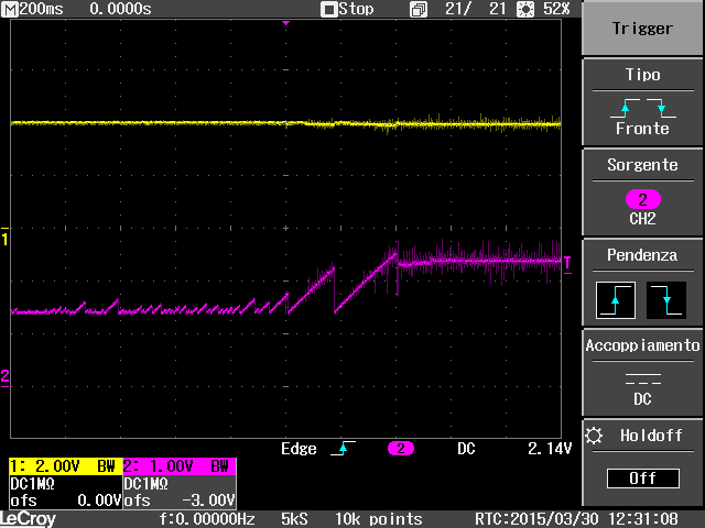

    SS@1°C:
    after few moments LM5041 try to start like COMP signal, until it start
