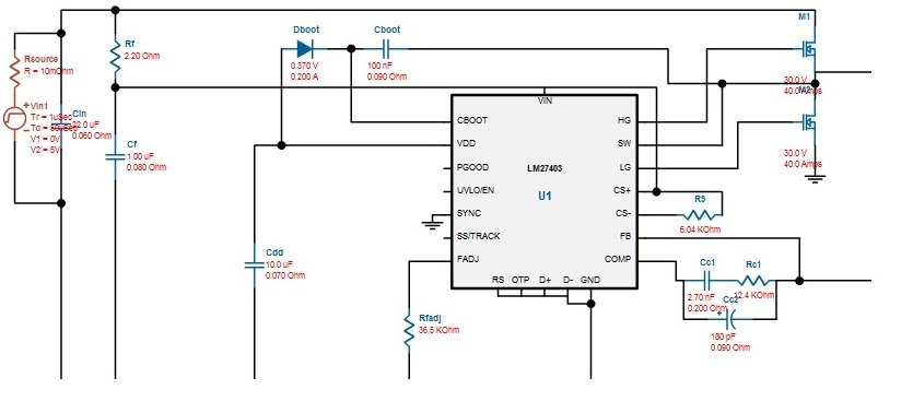

    May i ask another question to you or somebody else who is familiar with the LM27403?
    I would like to disable the OCP. The comparator may must have a voltage difference for about 20mV. So my thought is to shortcircuit CS- to CS+ with a resistor (6K). I have shorted D+ to D- also. so the current limit offset current  is about 5uA (see 7.5 on the manual) and with a 6K Resistor i will have about 30mV.
    Or do i have supply the CS+ with voltage from VIN?
    Thank's for verify my thoughts
