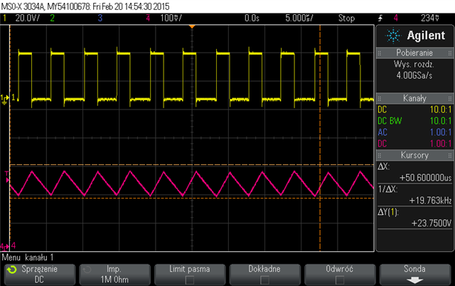

My design parameters is: Vin = 18..32V, Vo = 15V, Io = 1.5A. The switching freq is about 200kHz.

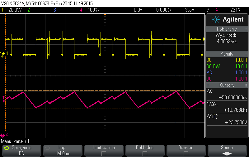

For the voltage mode (when the output voltage is constant = 15V) there is no problem. When the output current increases the output voltage of the converter goes down, and for the Vin = 32V, and Vout ~12V the working freq is stable and the waveforms of the SW voltage (yellow) and inductor current (red) are pictured below:

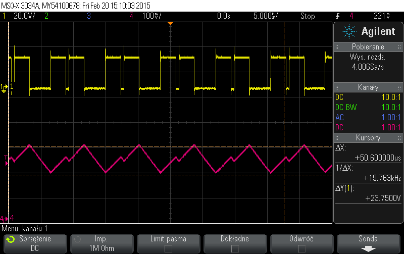

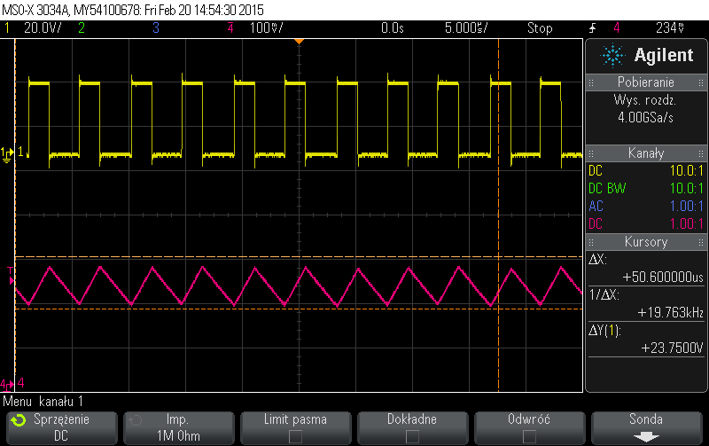

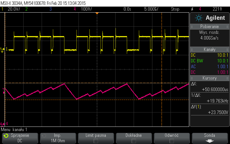

But when I start to decrease the input voltage then I can see some "stable instability" (see below)
Vin = 24.5V
Vin = 20V
Vin = 18.8V
Can you please explain what is going wrong with the circuit. I can't find any description in the datasheet nor in app notes why it is happening. According to the datasheet when the overcurrent occures I should see stable waveform on the scope (see page 12 of the LM3150 datasheet).
