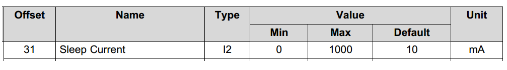

Are there any single cell gauges capable of distinguishing between > 500 uA for NORMAL current and <50 uA for SLEEP current?
I have a very small (< 75 mAh) battery. Gauges like bq27621-G1 and bq27421-G1 seem like a good fit, except it appears that the Sleep Current for these cannot be below 1 mA. In this use case, the system spends a lot of time in an 'idle mode' that draws between 0.5 and 1.5 mA, and I'd like to keep the gauge active in this state to keep the state-of-charge as accurate as possible.
From bq27421-G1 TRM p30:

  • Hello Jonathan,
    How big is the battery of the device? The bq27421 has a coulomb counter and might not be able to distinguish between the two current consumption modes. However, if there are changes in the voltage, then the bq27621 will be a better fit.

  • Hi Kang,
    The battery is between 30-70 mAh. Would bq27621-G1 be able to stay in NORMAL mode with load currents of 500 uA, and transition to SLEEP mode when that current drops below 100 uA?
    Jonathan
  • Hello Jonathan,
    Is it possible to ask the customer to provide a voltage profile of when the current is 500 uA transitioning to below 100 uA?
    Depending on the internal impedance of the small cell, this might be a very hard application to handle.
    The discharge rates vary between C/700 to C/140. Both of these discharges are negligible to the size of the battery.
