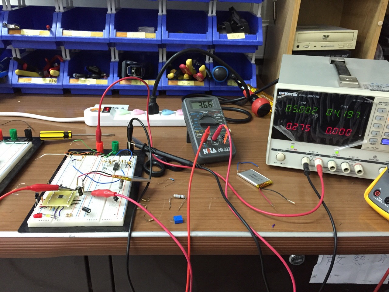

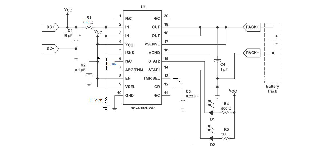

I have a bq24002 ic and I use the circuit by datasheet
my circuit
Rsns : 0.1 ohm
I open APG mode
my cell : 600 mAh  4.2V
charge time 6 hours
when I start , the cell open voltage is 3.51V
power  on the current 0.278A   not 0.6A
Why ??????????????
the charge is on 1C constant current
but  I don't see that in my circuit
 Please solve my question  THX
  • What is the status on two status pins (STAT1 and STAT2)?  Do you have a schematic of the circuit? Note that all the measurements should be measured as close to the IC ouput pins as possible. It looks like you will have a lot of voltage drop caused by the wires. Also, please make sure your input voltage is > VUVLO. Using RSNS = VILIM/IREG gives RSNS = 0.17 ohm for 1C constant current for your battery.

    the constant current  0.215A
    the voltage in pins
    VCC pin4 = 4.975V
    ISNS pin5  =  4.856V
    APG pin7 =  0.9V
    EN and VSEL pin8,9 = 4.975V
    CR pin12 = 2.912V
    VSENSE pin17 = 3.873V
    OUT pin18 = 3.913V
  • VILIM = 0.1 V (typ) is an internal reference voltage. You can find the value of VILIM in the current regulation section in Electrical Characteristics table. How are you measuring the current. Measuring current using a current probe, such as the Agilent 34134A AC/DC current probe, will result in a more acurate measurenmt than connecting an amp meter in series. We do not currently have BQ24002 EVM in our lab. I will order one and get back.
  • Thank you for your help
    I measure correct current = 0.6A
