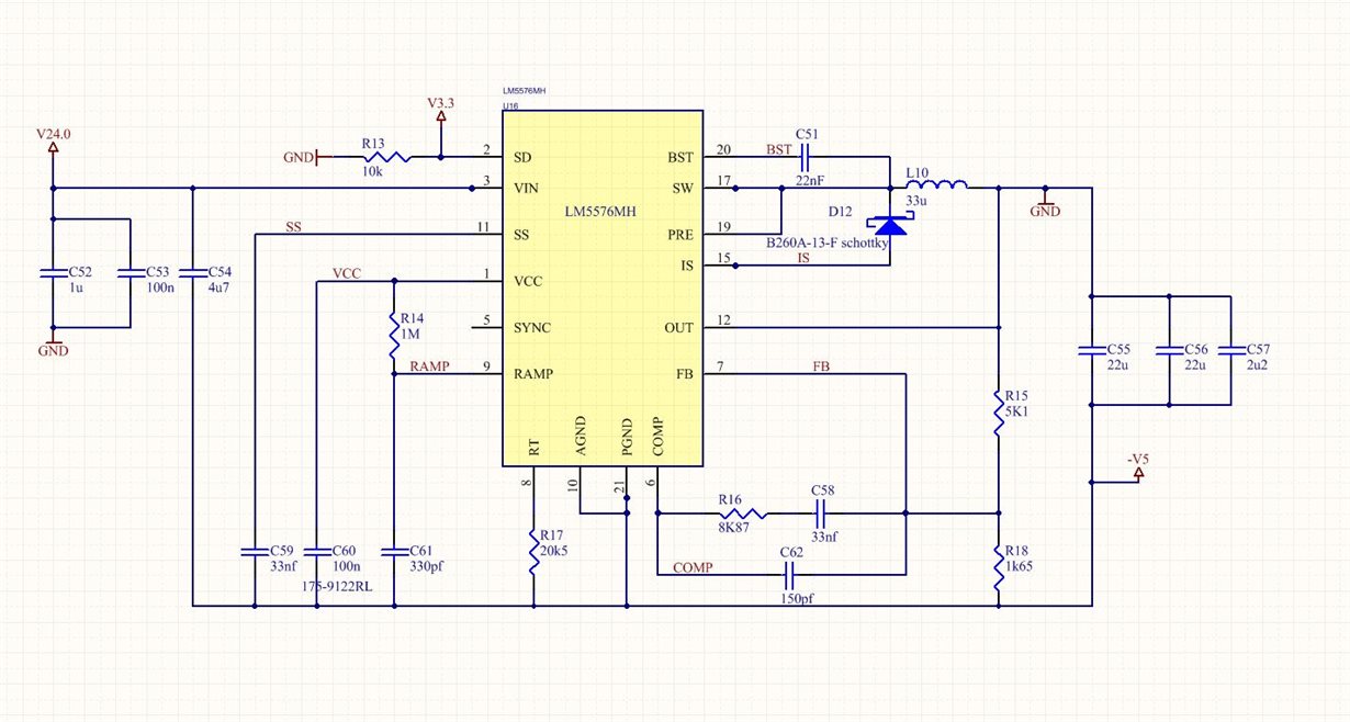

I am having an issue regarding the LM5576 device.
I have used one of the WebBench designs and it seems to work fine. When I plug in the power (24V) and I press the ON switch, the LM5576 turns ON fine but when I turn OFF the circuit the -5V remains there.
The way the board works is that the ON switch enables the 3V3 volts and this 3V3 enable +5V and -5V simultaneously.
I am using a LM22675 for the +5V and it shuts down fine.
I have measured the voltage at the SD pin of the LM5576 and it goes low, but the -5V somehow remains there.
Any Ideas?
PS:This is the Schematic
