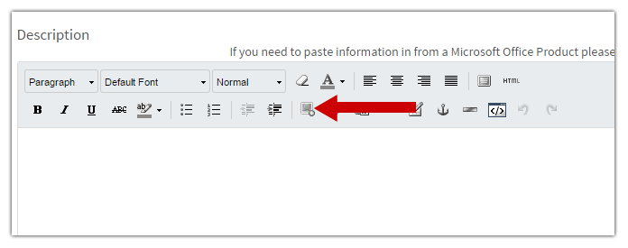

    Sorry to hear you were having issues getting content pasted in. For attaching files see this reference guide. For inserting images, our rich text editor won't allow images to be directly copied and pasted in (will need to be local on your drive to then be uploaded).
    For inserting images:
    Click on the insert image icon in the rich text editor.

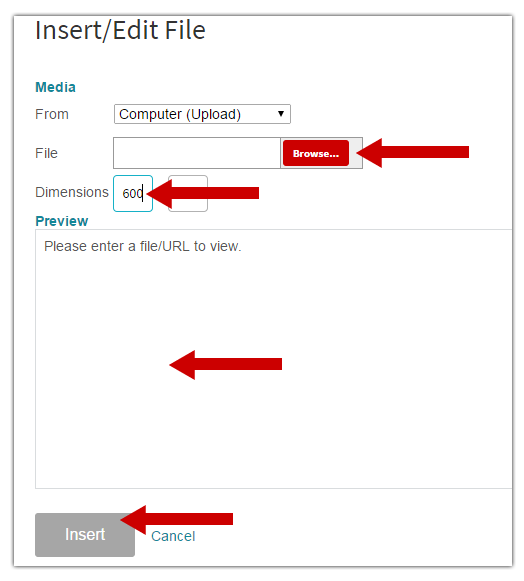

    Next: In the pop-up box click on the red "Browse" button to locate the file on your drive. Once selected be sure to input its width pixel dimension (for best display). Once the image is fully uploaded it will appear in the preview pane and at that point click on "Insert." You can also drag and drop images from your drive as described here but this method will allow you to specify the exact width of your image.
