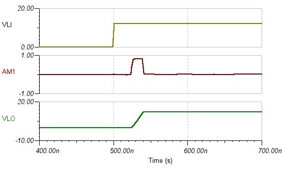

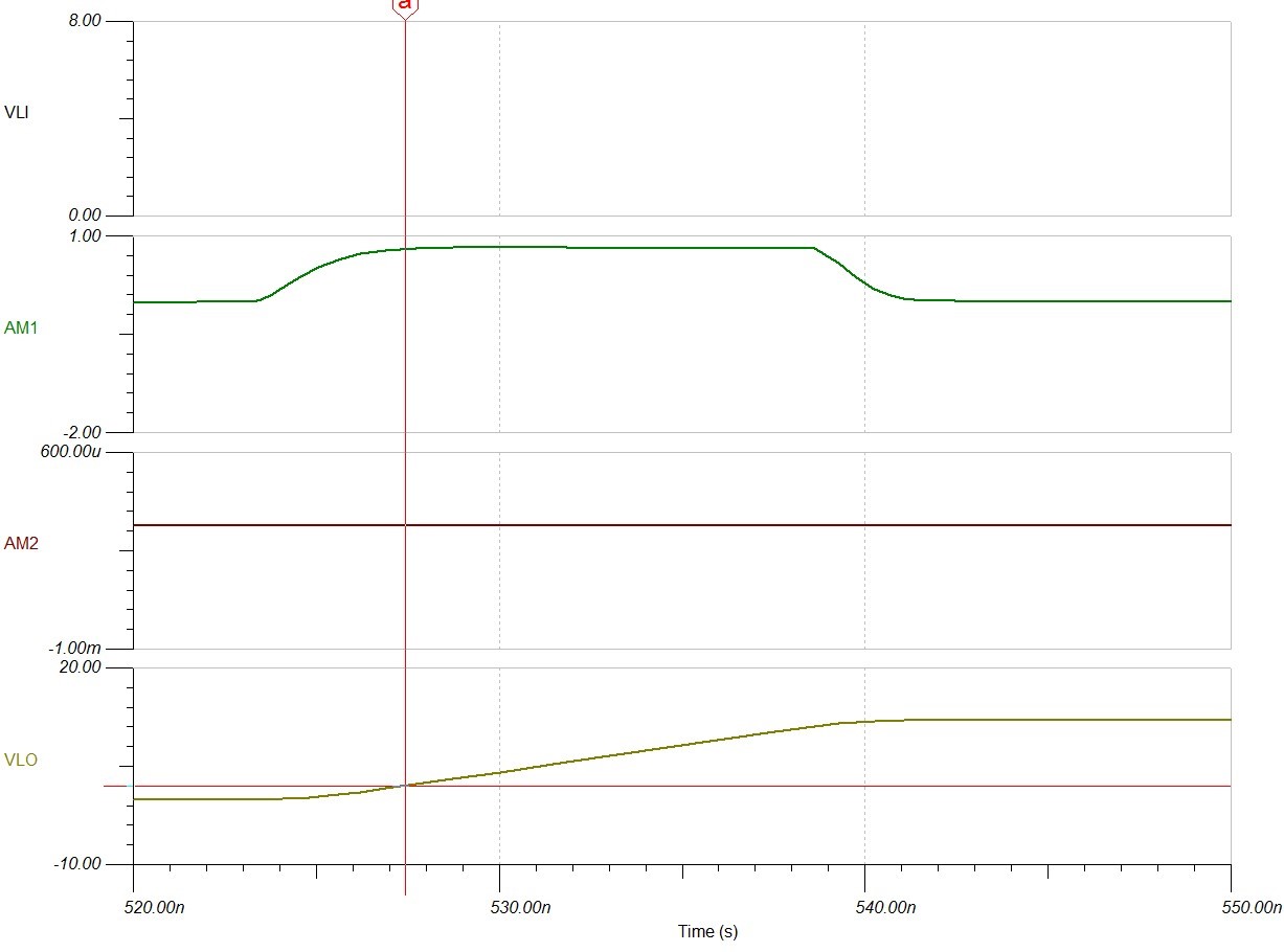

I am perplexed with how to achieve the 4A rated current of the UCC27211 gate driver. I found in practice and then with simulation using TINA-TI that the driver tends to saturate at a lower current. Using TINA-TI I further noticed that the level of saturation current seems to depend somewhat on the capacitance of the load. I don't understand why this would be the case, or how the internals of the UCC27211 could accomplish this. My goal is to get the fastest switching speed possible and this saturation current is limiting. I think that the TINA-TI simulation is without parasitics. I have attempted to attach plots of various load capacitances and a screenshot of the simulation, which was taken directly from the website. Sorry for the different timescales, but I wanted to illustrate that current saturates at low values for low capacitances, thus increasing the switching time if that was a gate capacitance.

  •  This is useful information. I have scoured the datasheet and noticed that information. I also am aware that once I get 4A the design might not be able to handle it. But I'd really like to test at full switching strength, as the switching losses uses a lot of power in our design.  I'm wondering how I can ensure the design to get the maximum currents out of the device and fastest switching times. For example, the datasheet lists the rise time for a 1 nF load as 7.2 ns. I simulated a 1 nF load and I see the current rise to about 800 mA in 4 ns  while the driven capacitor voltage is about 2 V. The current then just stays at 800 mA until the capacitor is charged. Clearly if this was a gate drive capacitance, it wouldn't be turned on and it would only be driven across the miller plateau at 800 mA instead of 4A. This design is only in simulation so I don't see what else I could do to get more current out of it.

    I think the problem is that the TI model doesn't really reflect the true device performance very well. For example, I downloaded the UCC27211 TINA-TI Transient Reference Design schematic from the website and had it drive a IRF630 MOSFET. The model displays no miller effects and the output current (AM1) continues to flow even when the gate has already reached 12V - cursor
