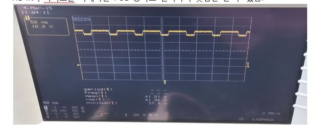

Recently, one of POE camera using CAT-5E connect to HD4K. But does not operated. Because TPS2384 in HD4K  does not recognize POE device.
show below TPS2384 waveform... "... but the other POE camera operated well in HD4K.
and POE camera (dont worked in HD4K) operated well if connected to POE Hub.
if you have a solution or good idea, please advise to me.

  • According to the plot, TPS2384 measured an invalid detection resistor from the PD. Does this PD work on other TPS2384 ports or fail on all of them? One PD test is to apply voltage to the power port between ~4V and 9V and measure the current using a uMeter. You can use  simple DC power supply with DMM in between with a modified ethernet cable. The V/I should be around 25kohm. TPS2384 will fail below ~16kohm and above ~30kohm. The PD should be between ~23k and 26.5kohm.

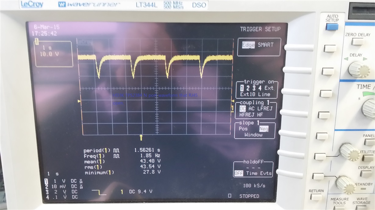

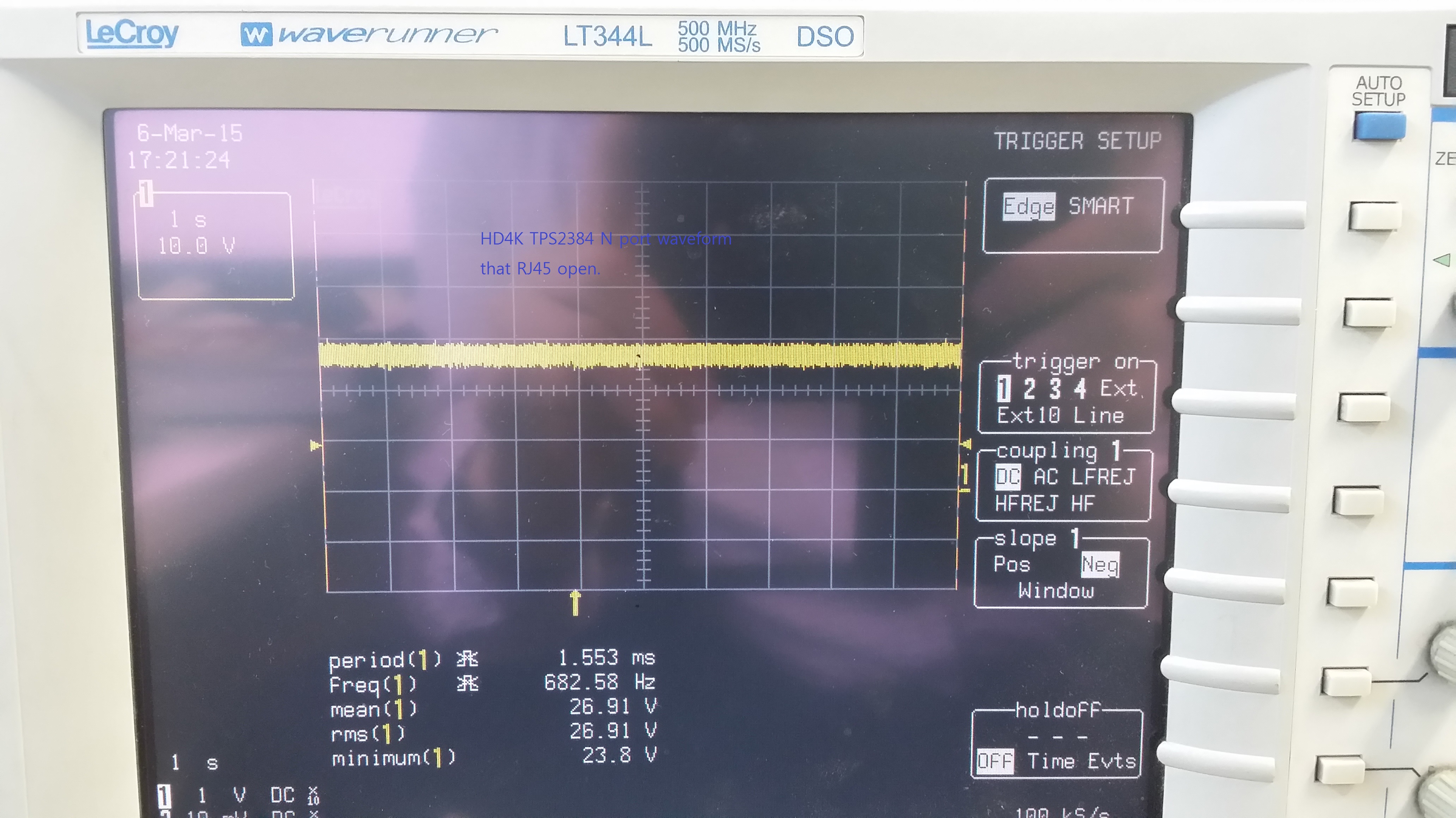

  • today I upload HD3K circuit(PDF) and 2 waveform.
    In the HD4K, N port of TPS2384 wavefrom does not change(always about 27V)
    but HD3K, N port waveform does not. why???
  • I cannot find anything wrong with HD4K schematic, however I cannot see where the Px+/Nx- signals go. It could be that connection is causing the issue. The HD4K waveform indicates that the port is not even searching (searching is the periodic open circuit probe waveform you show in HD3K). You mentioned that applying a soft reset will clear the condition, right? When you do this, does the HD4K searching waveform come back?
    In HD4K, you apply the PORB signal through the opto. It is possible that the reset timing causes TPS2384 to power up with ports disabled. Also in HD4K, the PSE_3.3V is used or pullups. This can only power ~2-3mA so check the DCV of that node to ensure that V3.3 is not overloaded.
  • I try to soft reset TPS2384 in HD4K, but waveform did not changed.
    I remove C26(0.22uF between P and N pin) In HD4K, then I can see similar waveform(voltage level 0v~27v) to HD3K.
    is there important artwork guides for using TPS2384??
    i can't understand why disappear "searching waveform" if I attach 0.22uF between P and N pin.
