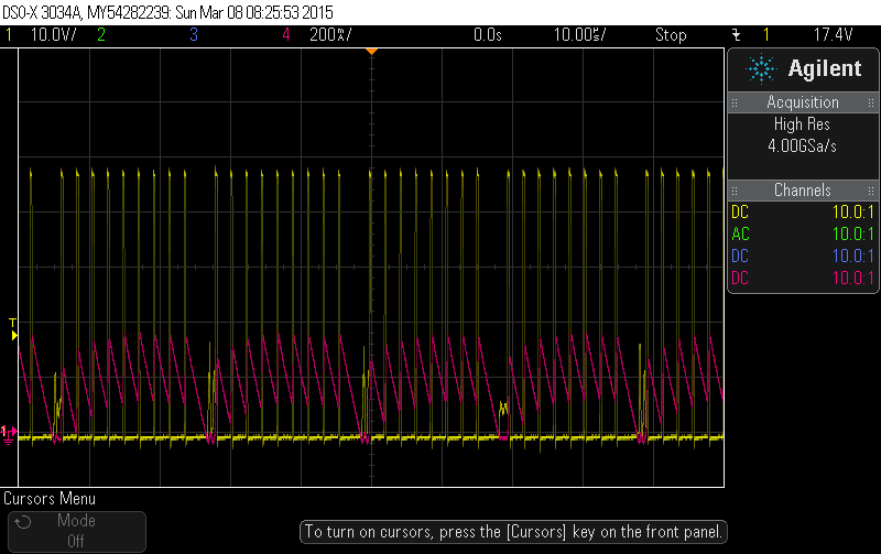

My application for the DRV8301 integrated DC/DC requires a 5V output and operation from a large input voltage range (20-48V).  Ideally, the DC/DC would be stable throughout the entire input voltage range.   However at 48V, the design is right at the edge of pulse skipping.   With typical load I have a perfectly stable output PWM.  However, with just a small reduction in load I get periodic pulse skipping:
  • Red : Inductor Current
  • Yellow : PH node voltage
The pulse skipping is not caused by the minimum on time requirement (t_ON > 130ns).   For 48V to 5V the max frequency is ~= 800kHz.   I'm running at 450khz, and the on pulse-width is about 300ns.    It looks like the converter is entering "Pulse Skip Eco-mode".

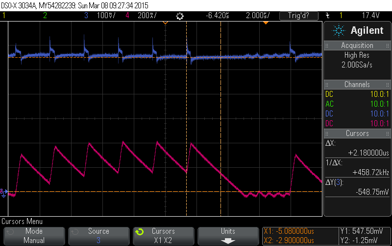

Unfortunately the datasheet doesn't do describe Eco Mode much more than this.    Figure 8.2 (Function Block Diagram) seems to indicate that EcoMode is entered when COMP pin voltage is less than some threshold,  however it doesn't specify what the threshold is or when in the switching cycles this matters.  I've put a capture of the COMP pin voltage below.
  • Blue: COMP pin voltage
As you see the the threshold voltage seems to be about 500mV, and my design is just at the edge of pulse skipping mode.
