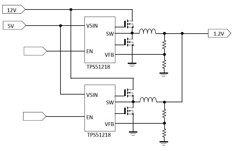

Customer would like to use 35A like current share to gather 2pcs of TPS51218 like below.
Is this avalable to use like below?
Thank you for your cooperations

In general you cannot do that. There is no means to provide for current sharing. One converter may supply most or all of the current.
